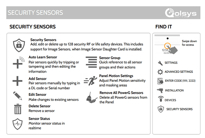

Below is the pathway taken at the panel to access sensor programming. We recommend manually programming the sensor.
To do so, tap Settings > Advanced Settings > enter installer code > Installation > Devices > Security Sensors.
Use the Add Sensor option and this will open the sensor configuration page. First set the Source field near the bottom right to PowerG. From there, enter the sensor’s 7-digit ID printed on the sensor (and on the box it comes in) in the appropriate field and program the remainder of the fields as desired.
