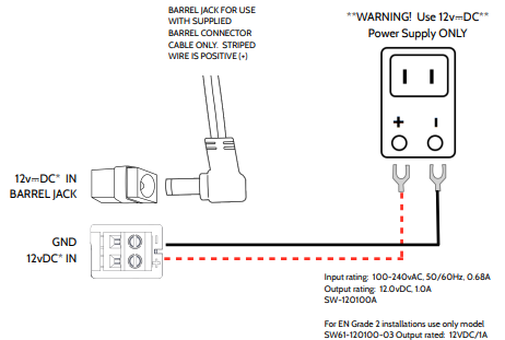

2. Power On the Panel
The IQ Panel 5 has a different power supply than the IQ Panel 2 and the IQ Panel 4. If upgrading from one of those systems, you can use the same barrel jack connector but will need to replace the transformer. IQ Panel 5 and IQ5 Hub uses 12V DC power
Qolsys panels usually ship with the battery disconnected. You’ll need to connect the battery first, and you may even need to give it some time to charge up before the panel will power on. This is normal and expected.
