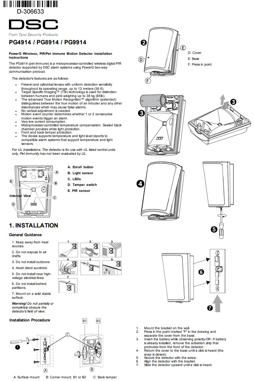

How to Install the PG9914
Physical installation of the PG9914 motion detector should follow the manufacturer’s instructions found in the product installation manual. Installation steps from the PG9914 manual are below:
A link to the PG9914 full manual can be found here:
Mounting the PG9914
Sensor Installation
- Keep away from heat sources.
- Do not expose to air drafts.
- Do not install outdoors.
- Avoid direct sunshine.
- Do not install near high voltage electrical lines.
- Do not install behind partitions.
- Mount on a solid stable surface.
Warning! Do not partially or completely obscure the detector’s field of view.
