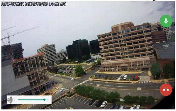

Swipe left on the Qolsys IQ Panel 2’s home screen until you reach the Live Video Cameras page.
  1. Tap to select the camera to view.
  2. Tap the Play icon to view the live video stream from the selected camera.
  3. On the live view:
  • For video cameras that support two-way audio:
    • To talk through the camera, tap and hold the Microphone icon.
    • To adjust the audio coming from the camera, tap and drag the volume slider.
    • To end the live stream, tap the Hangup icon.
Additionally, for Alarm.com Doorbell Cameras, the system can be disarmed from the live video on the panel.
  • To disarm the system, if the system is armed:
    1. Tap Lock icon.
    2. Tap > on where it states the current status of the security system (i.e. Arm Stay, Arm Away, or Disarmed).
    3. Tap Disarm.
    4. Enter a user code to disarm the system.
  • If using Z-Wave locks, the locks can be unlocked/locked from the live video on the panel. To unlock/lock Z-Wave locks:
    1. Tap Lock Icon.
    2. Tap > for the lock.
Tap Unlock if the door is currently locked, or tap Lock if the door is currently unlocked.
For video cameras that do not support two-way audio, only a red X is on the screen to close the live stream.

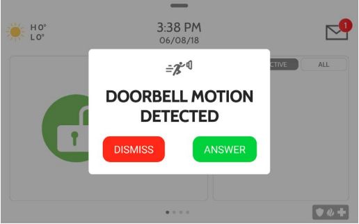

Using an Alarm.com compatible Video Doorbell?
Once you have set up live video, you can also enable notifications from the Video Doorbell to be sent to the panel as well.
The following is currently compatible:
  • SkyBell Doorbell Camera (ADC-VDB101/102/105/106/105x/106x) on the latest firmware
  • Alarm.com Video Doorbell (ADC-VDB770) on the latest firmware
To Enable the Doorbell Camera notification:
  1. Log in to the Alarm.com Website.
  2. Click Video .
  3. Click Settings .
  4. Using the Video Device dropdown menu, select the Alarm.com Doorbell Camera’s name.
  5. Click Video Device Info .
  6. Click to select Send motion notifications to panel and/or Send button pushed notifications to panel as desired.
  7. Click Save .
Notifications
The IQ Panel makes a notification sound based on its internal settings.
Depending on the type of notifications a user has enabled, the user sees either motion detection event notifications or button push event notifications on their panel screen.
