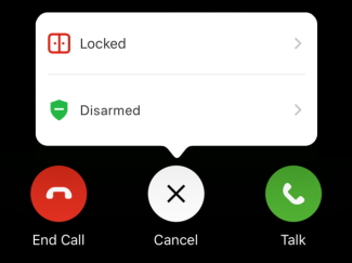

To control devices while on a video call:
  1. While on a video doorbell call, tap Actions.
  2. On the desired device category, tap > Arrow . The following devices can be controlled from the video call screen:
  • Arming Shield Security system: Arm away, arm stay, and disarm
  • Lock Locks: Lock and unlock
  • Garage Icon Garage doors: Open and close
  • Light Bulb Lights: Turn on and off
  1. Tap to select the desired device
  2. Tap the desired action.
