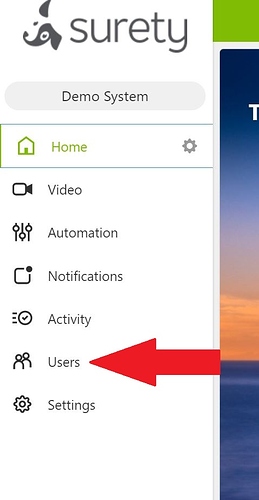

  1. To start of, click the Users tab in your Alarm.com account menu.

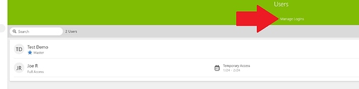

  2. Next, click on Manage Logins towards the top of the page.

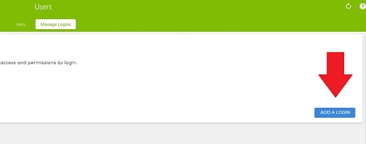

  3. Then click on the Add a Login button.

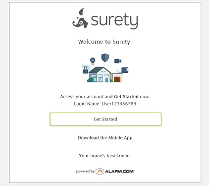

  1. Upon saving, an email will be sent to the address chosen prompting the new user to get started. Below is an example of what a Surety user might see.
  • Should the user not receive the email in their inbox, have them check their spam or other folders for the email. Should no email arrive, be sure to double check the email address. If it is correct, delete the Login from the Manage Logins page and start over.

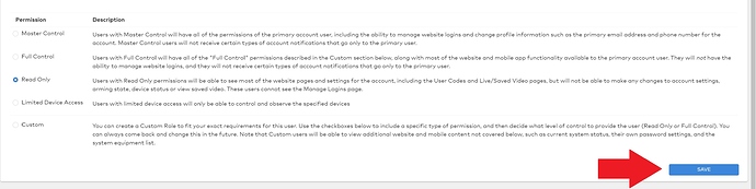

  1. Once the new Login has been created in step 4, you will then be prompted to choose that logins access level. Once you have selected the desired access level, click the Save button.
