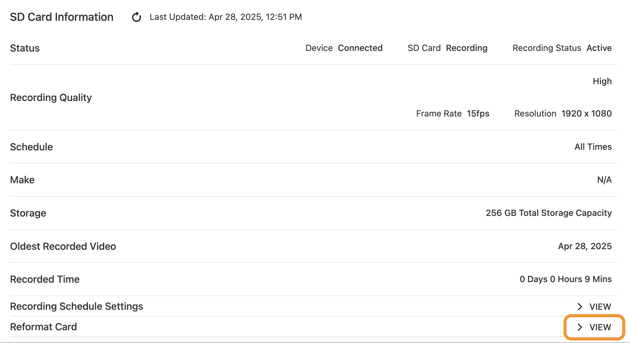

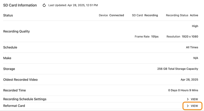

Format the SD Card
Your camera should automatically format and encrypt officially supported SD cards. If it doesn’t, then you will need to format the SD card manually.
To check the status of your SD card (including whether it’s formatted), log into Alarm.com and go to Video > Settings > SD Card Information.
If the SD card isn’t formatted then use the Reformat Card button to format it.

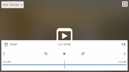

View SD card recorded video
To view Smart View on the Alarm.com Website
SmartView Timeline
  1. Log into the Alarm.com Website.
  2. Click Video .
  3. Click Onboard Timeline .
  4. Using the video device dropdown menu, select the desired device to play back.
  5. Click the Play Icon to stream the device’s recorded video.

To view SD card information using the Alarm.com Website:
  2. Click Video .
  3. Click Settings .
  4. Using the Video Device dropdown menu, select the desired device.
  5. Click SD Card Information .
