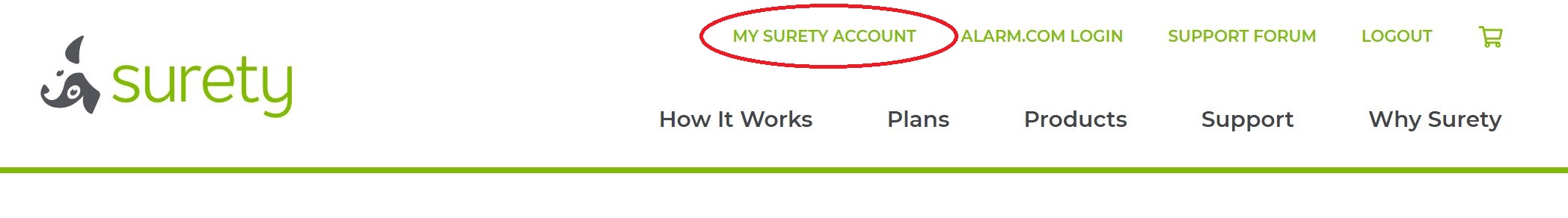

System Manager is access via your Surety login.
Login to your Surety account
From the dashboard menu, select System Manager
Next, enter the associated account’s Alarm.com login credentials.
If you have more than one service account, choose the correct account you wish to access

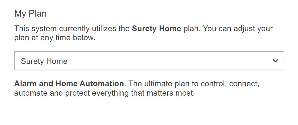

From here you can make changes to your service plan
Features and Pricing for service plans and add-ons can be reviewed here.

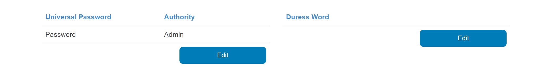

Add, Edit, and Delete account Verbal Passcodes
Adjust the call list order followed by central station operators and Add, Edit, Remove Contacts
