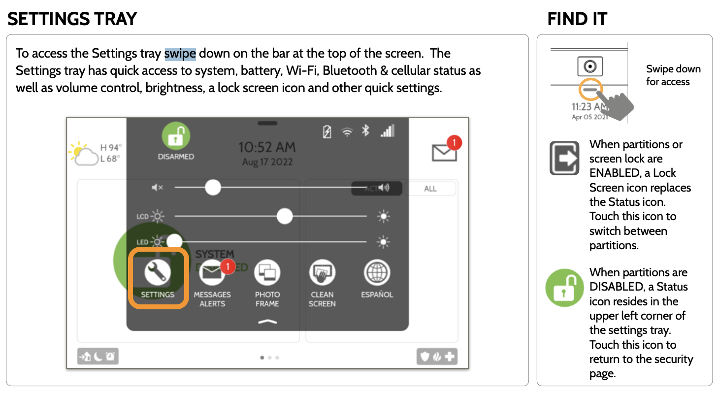

Open the Settings Tray by swiping down from the top of the home screen and choose Settings.
