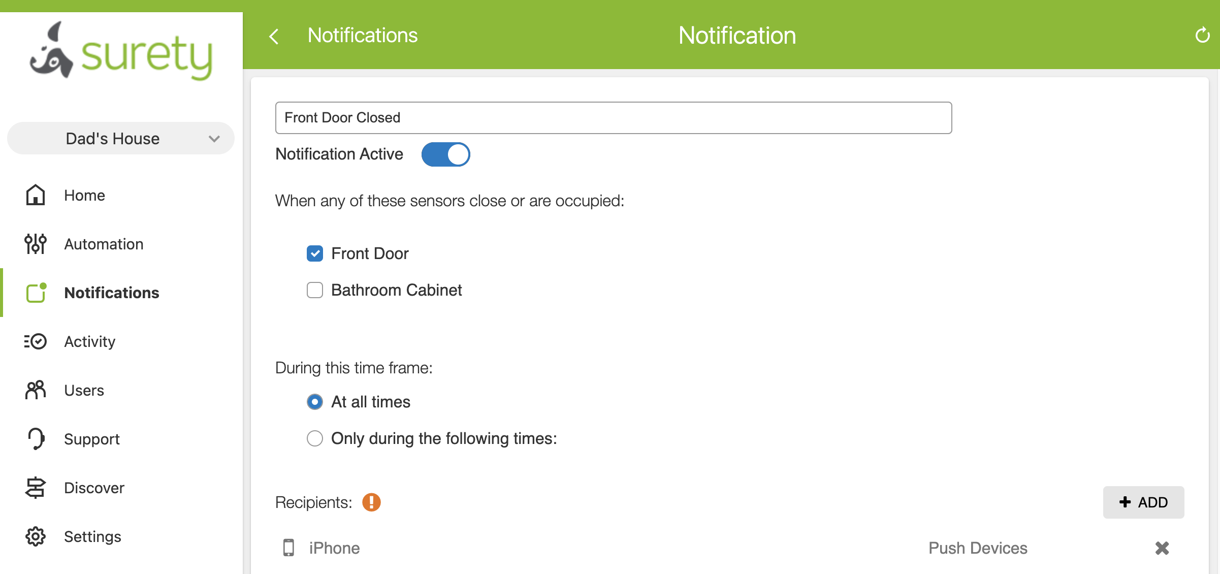

To get notified when a door sensor closes, use System Manager to add the Wellness add-on. Log into Alarm.com and do:
Notifications > New Notification > Wellness > Sensor Closed or Occupied
Then create your notification like any other.
