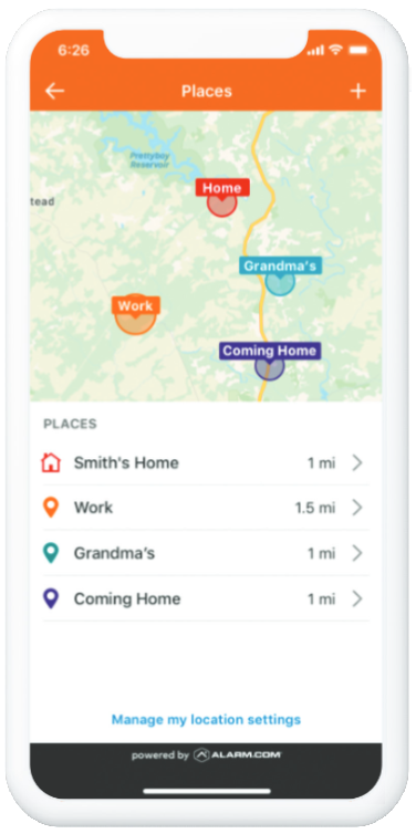

3. Verify the correct device is enabled for Geo-Services
You can verify the correct device is enabled by turning Geo-Services off in the app, then log into the Alarm.com website to verify a correlating device was paused. A device that is paused is grayed out.
In the following image, the Geo-Device named iPhone is enabled and the Geo-Device named Samsung is disabled.
Important : Remember to re-enable the Geo-Device in the app after this test.

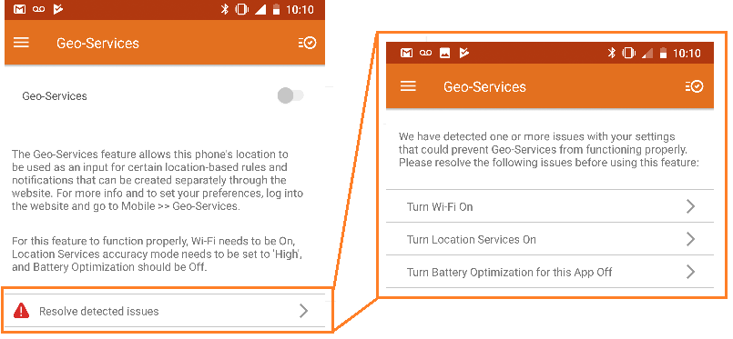

6. Verify settings that can affect Geo-Services on Android devices
For Android devices, there are several settings that can affect consistent Geo-Services functionality. The Alarm.com app also displays possible settings that are affecting functionality as shown in the following image:
Verify the Android device settings have the best corresponding values:

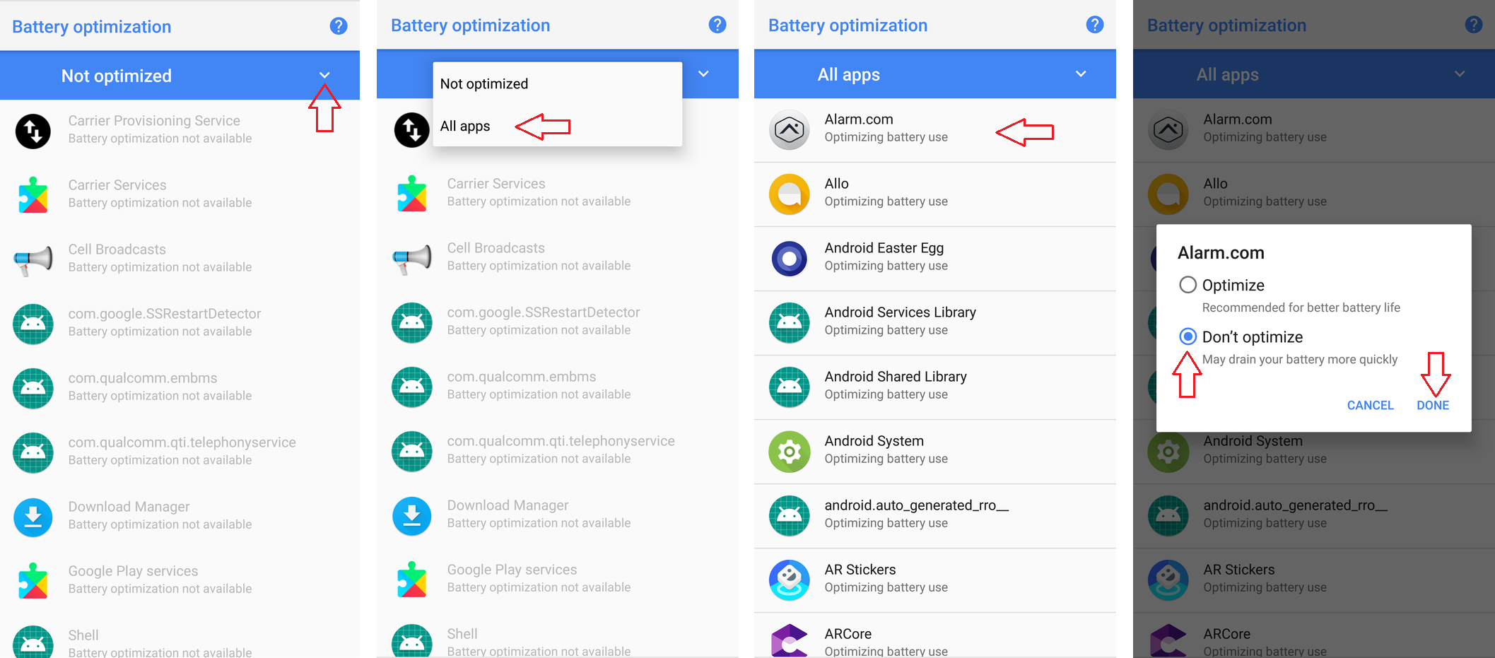

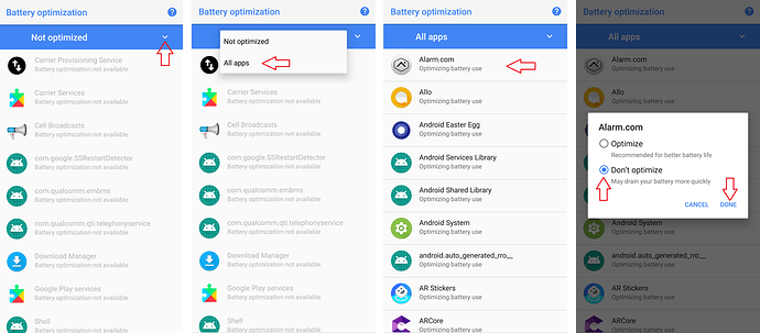

- Battery optimization or Optimize battery usage , which may be in the menu option of the Battery setting , should be toggled off for the Customer app, Google Play Services, Wi-Fi, and Bluetooth.
- When selecting the option to Turn Battery Optimization for this App Off from the Customer app, the phone displays the devices that do not have optimization on. Tap the arrow under Battery optimization to select All Apps, then tap Alarm.com to verify that Don’t Optimize is selected.
The following image is an example of turning off battery optimization on an Android device:
