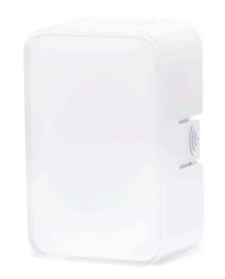

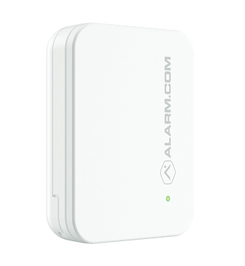

The Alarm.com Remote Temperature Sensor is a Z-Wave Remote Temperature Sensor (RTS) designed for use with the Alarm.com Smart Thermostat. When not paired with a Smart Thermostat, it can be used to provide a temperature reading from a location other than the thermostat, which is visible from the Alarm.com Website and app.
When an RTS is paired with a Smart Thermostat, the RTS can use its own temperature readings to dictate the heating and cooling provided by an HVAC system. It can even take the average temperature between other Remote Temperature Sensors or Smart Thermostats to dictate control of the HVAC system.
