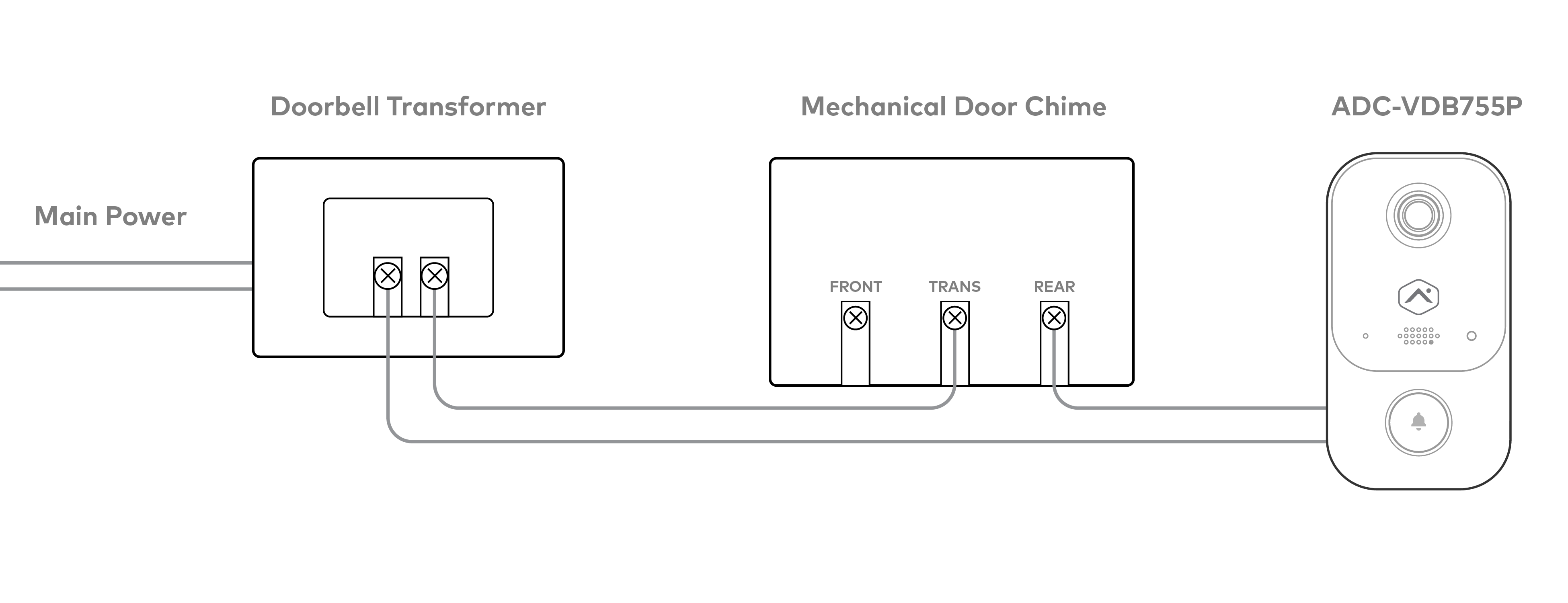

Wire the VDB755P to a mechanical or digital chime
After wiring the doorbell to the transformer, wire the doorbell using the screw terminals located on the wall mount assembly to the front or rear terminal of the chime.
