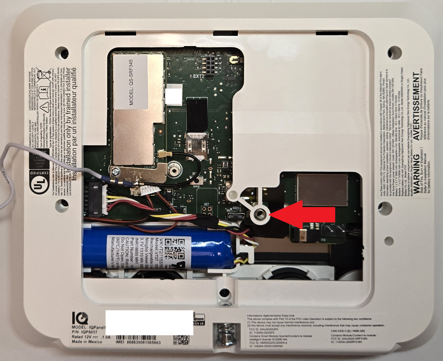

Qolsys IQ Panel 5, IQ 5 Hub, IQ 5 NS
The tamper switch on a Qolsys IQ 5 Series is the switch under the spring, located towards the lower-middle of the panel.
On both the wall mount and the table stand, there is a white post on the plate that should compress the spring and engage the tamper switch when mounted correctly.
With the panel opened, a tamper alert should populate. Pressing and holding down on the spring should actuate the switch and clear the tamper alert. You may need a small tool to access the spring in the plastic housing.
Check to make sure the switch can actuate freely and that there are no wires getting in the way of the back plate closing. Pay close attention to the RF Card antenna if installed as this can bunch up and cause the back plate to not sit flush.
