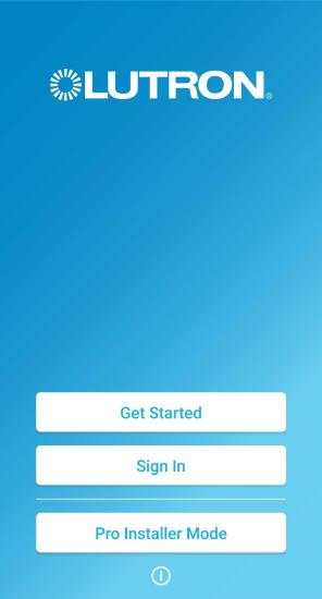

  1. Download the Lutron App from the mobile device’s app store.
  2. Tap Get Started .
  3. Instruct the customer to use their primary email and a temporary password to sign up a new account.
  4. Verify the phone being used for setup is on the same network as the Lutron Caséta, RA2 Select, RadioRA 3, or Homeworks QSX All-in-One Processor.
  5. Follow instructions to set up the Lutron Caséta, RA2 Select, RadioRA 3, or Homeworks QSX All-in-One Processor, and then associate devices to it.
