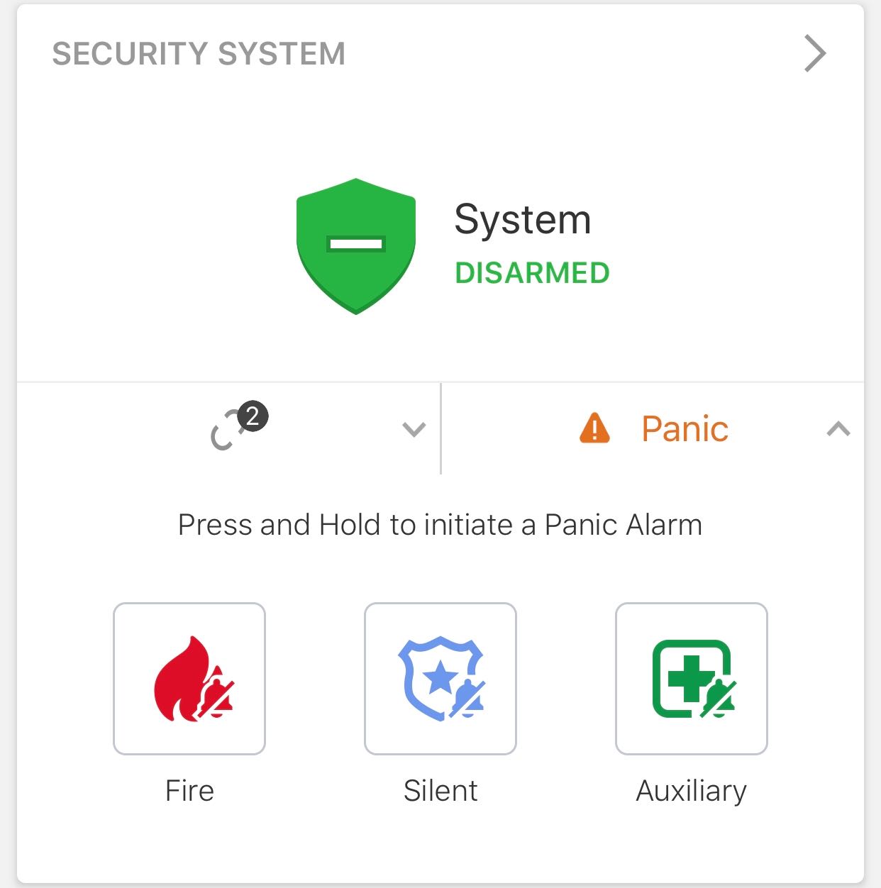

Important : While the Alarm.com app supports Fire, Medical, Police, and Silent panics, it will only display those that the panel supports remotely. If the panel does not support any panic buttons, the app will by default display a silent panic button.

The In-App Panel Panic will always show Police, Fire, Medical options; however, the behavior of the panel will depend on the user’s panel type.
For panels that support audible Police panics, users will see both the Audible and Silent version of the panic.

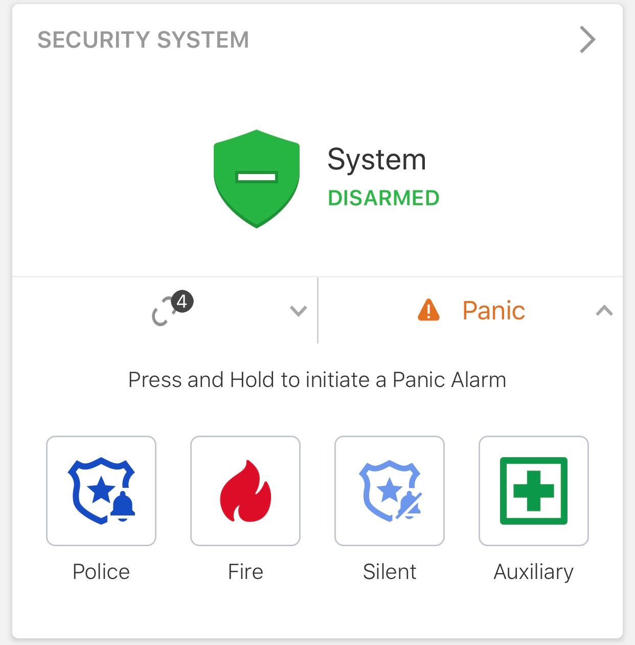

To trigger a panel panic from the Customer app:
- Log into the Alarm.com mobile app.
- In the Security System card, tap Panic .
- Press and hold the type of panic to be triggered.

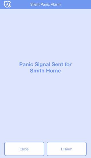

- After a 3 second countdown in which the panic can be canceled or immediately sent, the panic is sent to the monitoring station.
- Tap Close to wait for assistance or Disarm to disarm the panel.

What if the I send a Panic by mistake?
After pressing the panic button, a new screen pops up with a 3 second countdown and below the countdown is a Disarm button. Tap Disarm to negate the panic signal that was triggered.
