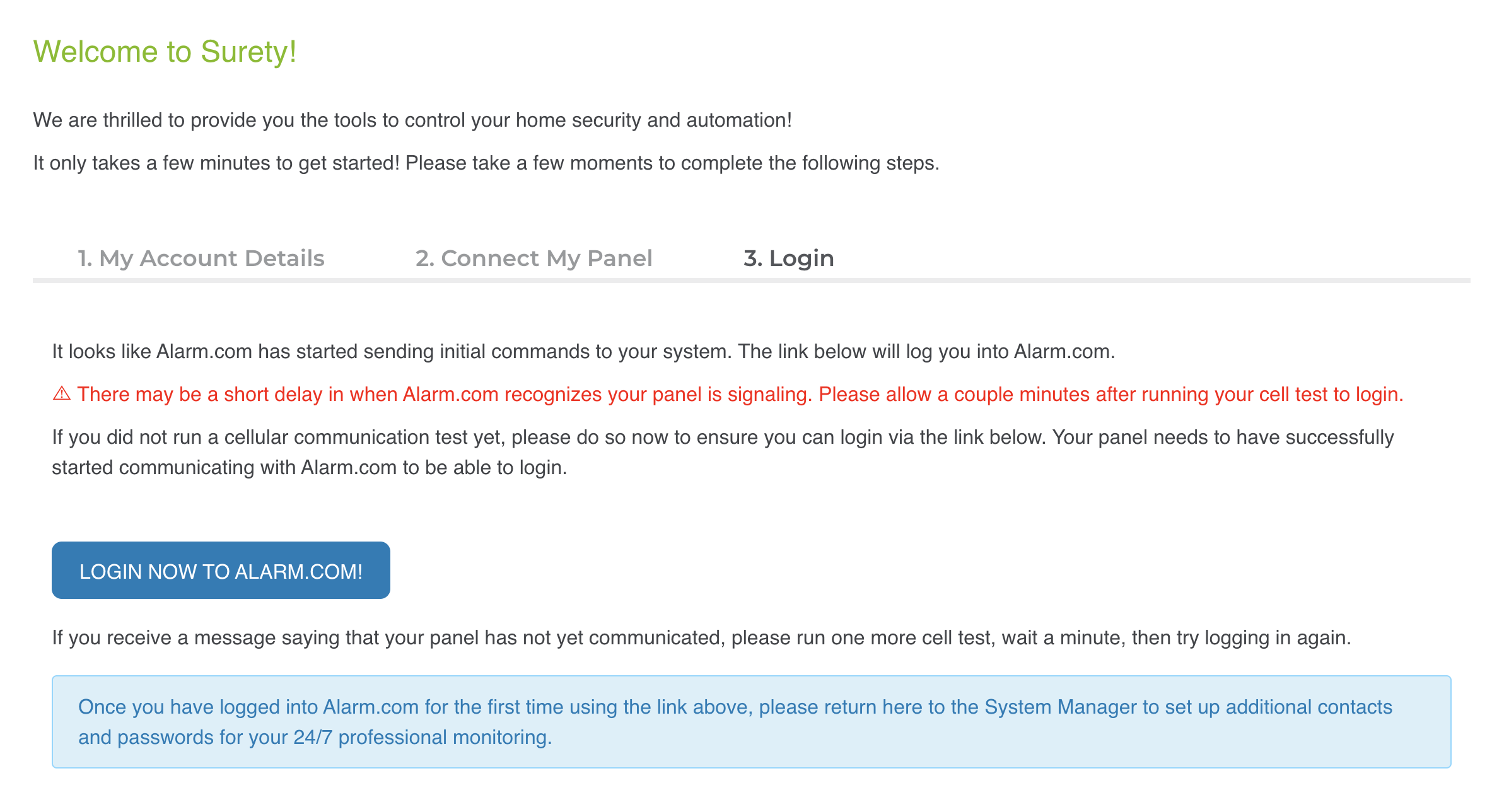

After you run your cell test, System Manager should show you this. Use that button to log into Alarm.com for the first time and set your password.
Sorry, we tried to make it easy with just a button press but if you get taken away from that screen, like it sounds like you did to run the cell test, then you won’t see it.

And yes… I see that screen, but clicking on LOGIN NOW TO ALARM.COM … takes me to the Alarm.com login. I enter my username and the temporary password, and it refreshes the page. Again… trying to reset password has been fruitless. I’m stuck in no man’s land right now.

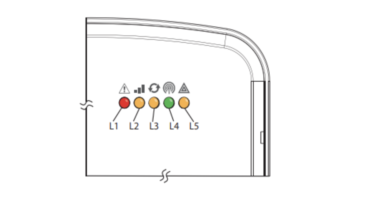

I believe you are using the TL880LT, correct? What do the LED lights show currently look like?
Is L1 (the red light) flashing at all? The number of flashes indicates the error number. If there are two or more errors at the same time, the errors flash one after the other. The LED stays off for at least 4 seconds between errors. It may take up to 10 minutes before L1 detects and flashes an error code.
If it’s flashing only once every 4-8 seconds, that means the module cannot communicate with the panel. The troubleshooting steps would be:
  1. Verify section [382] option [5] is ON.
  2. Verify panel software is version 1.11+.
  3. Check the connectors (between the panel and communicator).
  4. Power cycle the panel.
  5. If the error persists, there may be an issue with the module or panel.
If it’s flashing 7 times, that means The module is not compatible with this panel type. Insert a compatible module.
The other error codes are related to cellular communication which I can see is working.
I remember the L1 red button flashing every few seconds maybe, the L2 would flash a few times… the L4 would light up and go out, and the L5 would flash. I’ll follow the troubleshooting procedure tomorrow and hopefully we can get it fixed. I was sure hoping it would be something I could get resolved from home, but doesn’t appear that way.

If running a system test is the same as a cell test… we did that ladt night. I have now entered and exited installer mode. Red light is still flashing on communicator.
How many times is L1 flashing in a row currently? It will flash a number of times, then turn off for 4+ seconds. Is it only one flash every 4 seconds or so?
