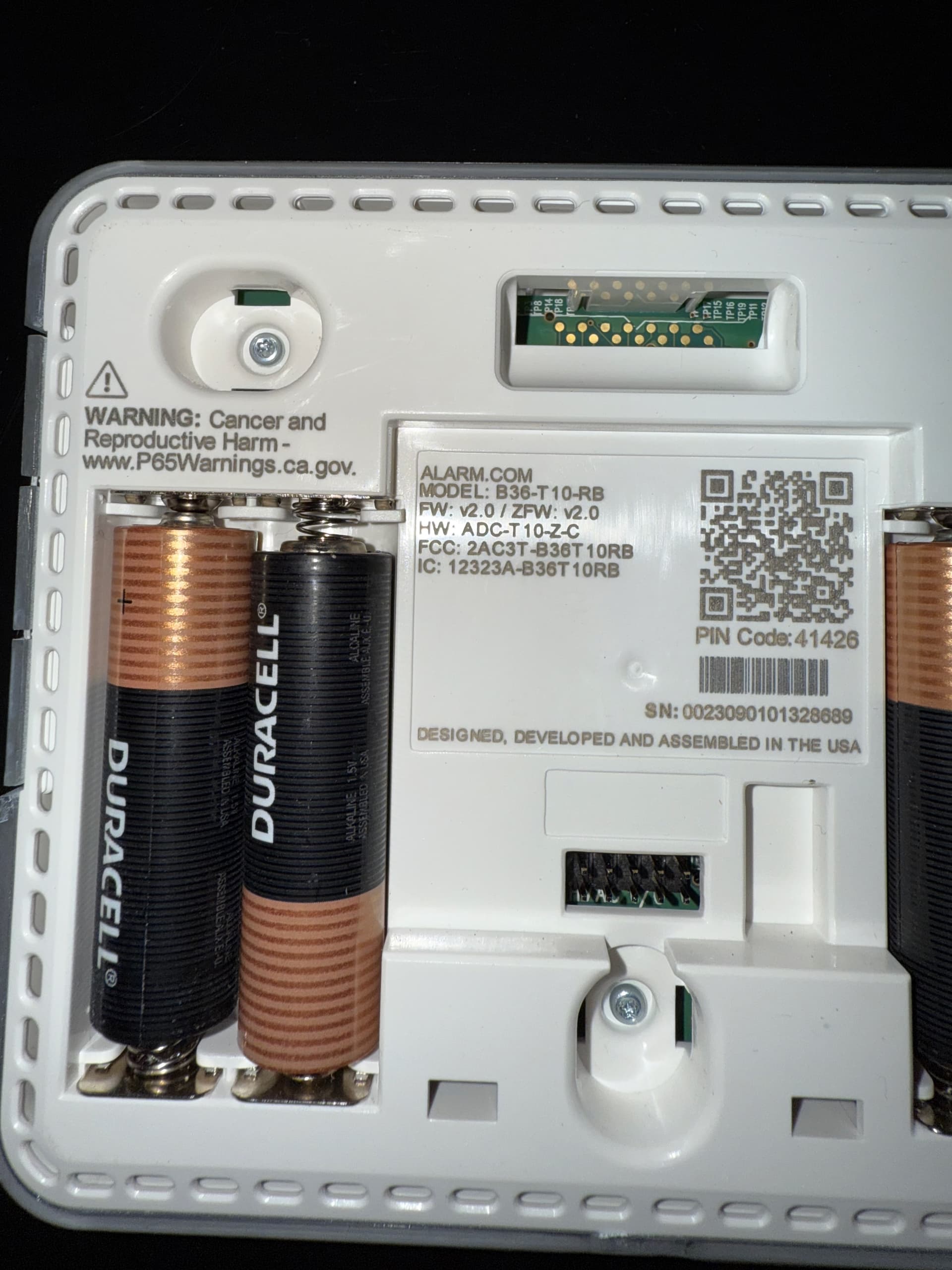

However this is not an ADCT2000, it is an ADCT10ZC
That’s an ADC T2000, the HW listed on the back will differ from the SKU. I have an older T2000 for testing and its HW is ADC-T10-Z-B.
The troubleshooting steps would still apply.
OK, great. Thanks for confirming
