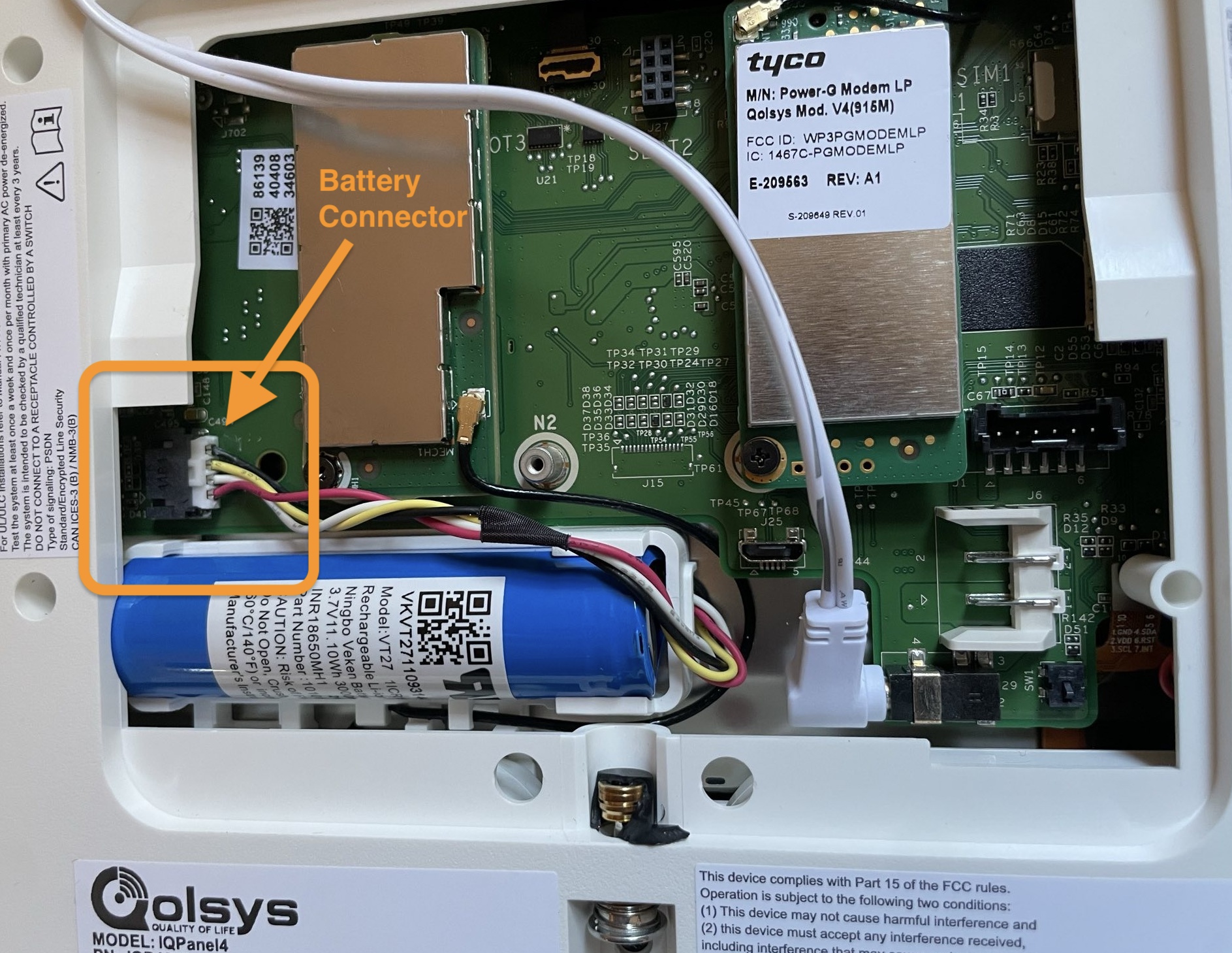

It could be that the battery is disconnected, very low, discharged, or entirely depleted. The IQ Panel 4 won’t boot up if the battery is disconnected or too low.
New IQ Panel 4’s are often shipped with the internal backup battery disconnected. The panel will not boot up until the battery is connected.
Check that the backup battery is connected
  1. Unplug the power supply from the wall to power down the panel.
    • Don’t disconnect power from the panel first, instead unplug the power supply from the wall first to prevent arcing at the connector.
    • Ensure you are using the included 7V power supply and cable.
    • If you are using an existing cable, make sure it meets the specifications outlined on page 12 of the manual.
  2. Open the panel up. Check to make sure the internal battery is connected. Then close up the panel and reconnect it to wall power.
  3. Hold down the power button for 3-5 seconds. You should see an Android logo then a Qolsys logo. The panel should fully boot at that point.
