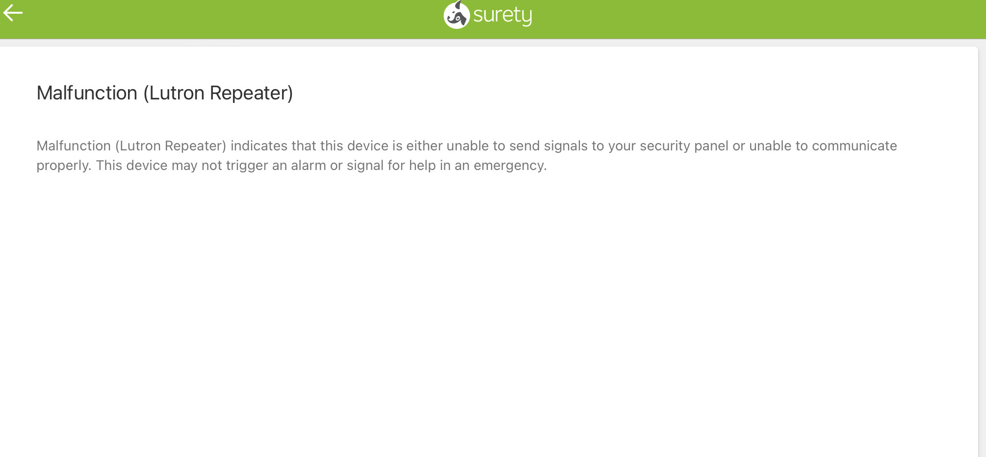

Locks showing offline is a separate Z-wave network signaling issue. I see the Kitchen, Courtyard, and Fire Bowl devices showing offline malfunctions in the past month. I’ve sent a Network Rediscovery to repair routes.
The Schlage BE469ZP has unfortunately been discovered to have issues with 2GIG GC2 and GC3 panels according to ADC. The GC2 and GC3 will not be seeing further firmware updates so unfortunately some inconsistencies are not possible to avoid.
Looks like immediately following that malfunction in communication to the main repeater resolved, the repeater started bombarding the Alarm.com event buffer with acknowledgements.
We are back to seeing hundreds per event for those Lutron devices. I’m sending this info to ADC to update the ticket that was forwarded to engineers.
