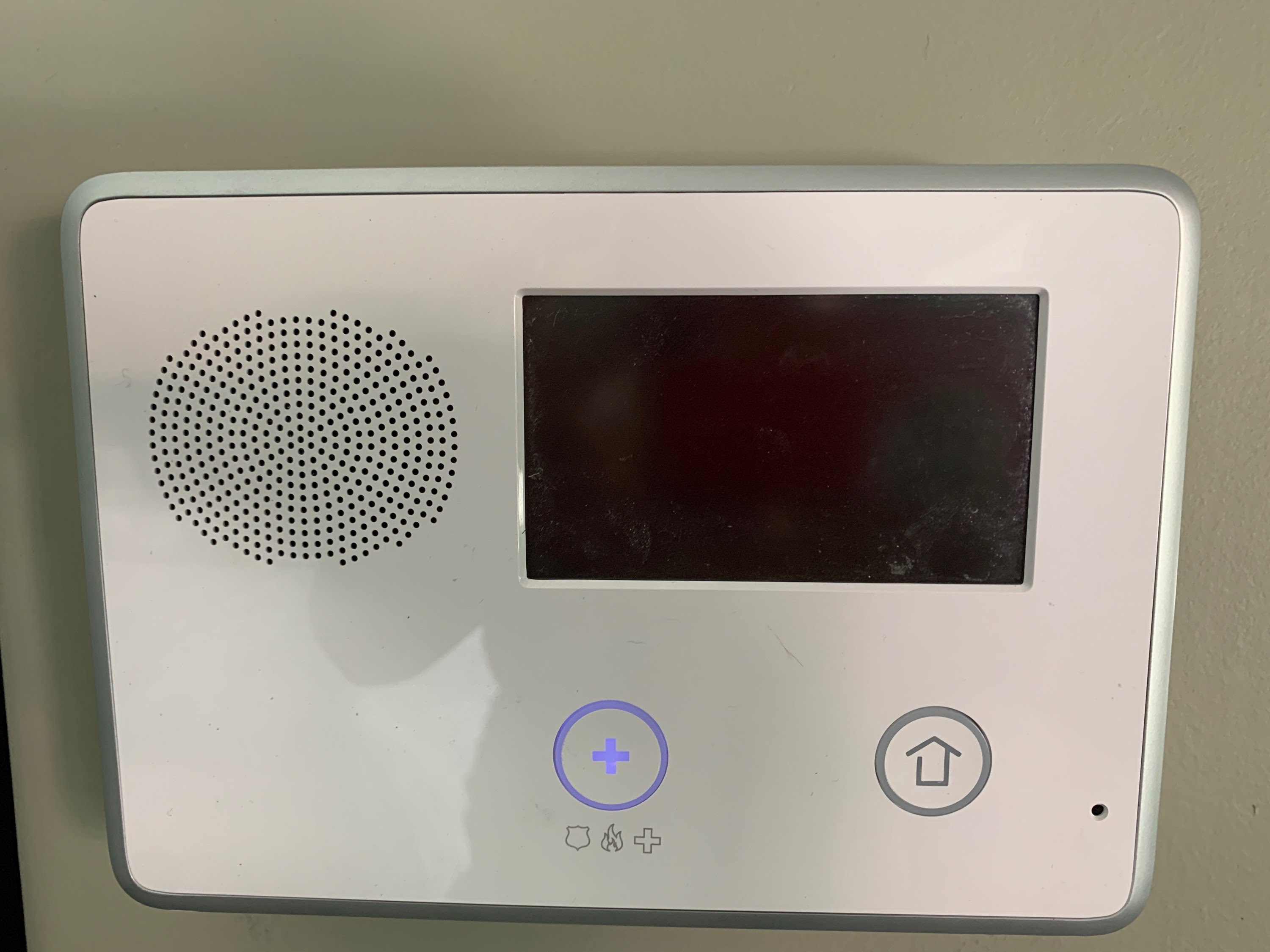

At exactly 3:23 PM my wife were both home and received a notification that our panel was disarmed… The panel did not make any sounds or announcement. The notification came from ADC
I suspected someone scanning my system or remotely taking over. I have security cameras and no one and no cars outside the perimeter of my home.
Can you give me insight into this? A bit un nerving

I believe it was purchased in 2016. I had the original 2 Gig Panel and then Surety recommended I upgrade to the most current version of the GC2. I believe this the version right before the encrypted panels…
Ok, that’s not the oldest radio version, yeah that’s what I wanted to know.
