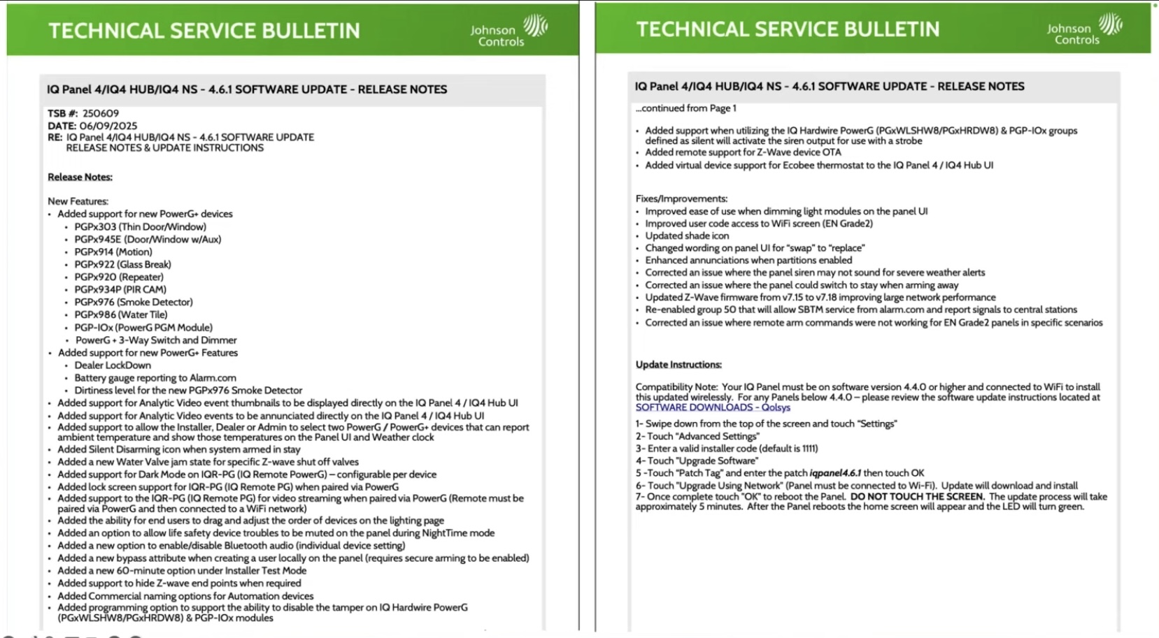

Version 4.6.1 for IQ4, IQ4 Hub and IQ4 NS has been released.
Yes, we are currently testing internally. Official announcement and upgrade instructions will be posted soon.

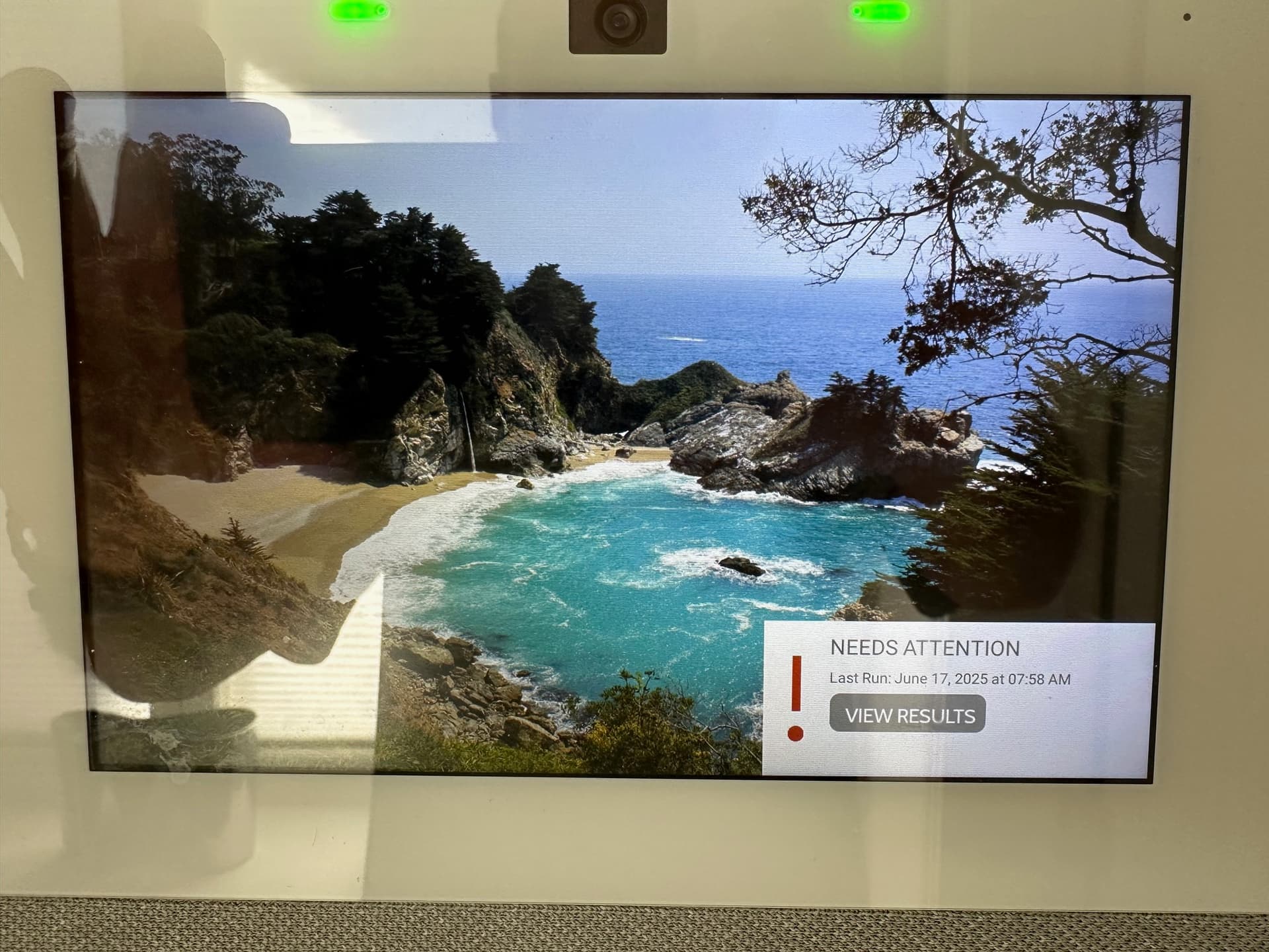

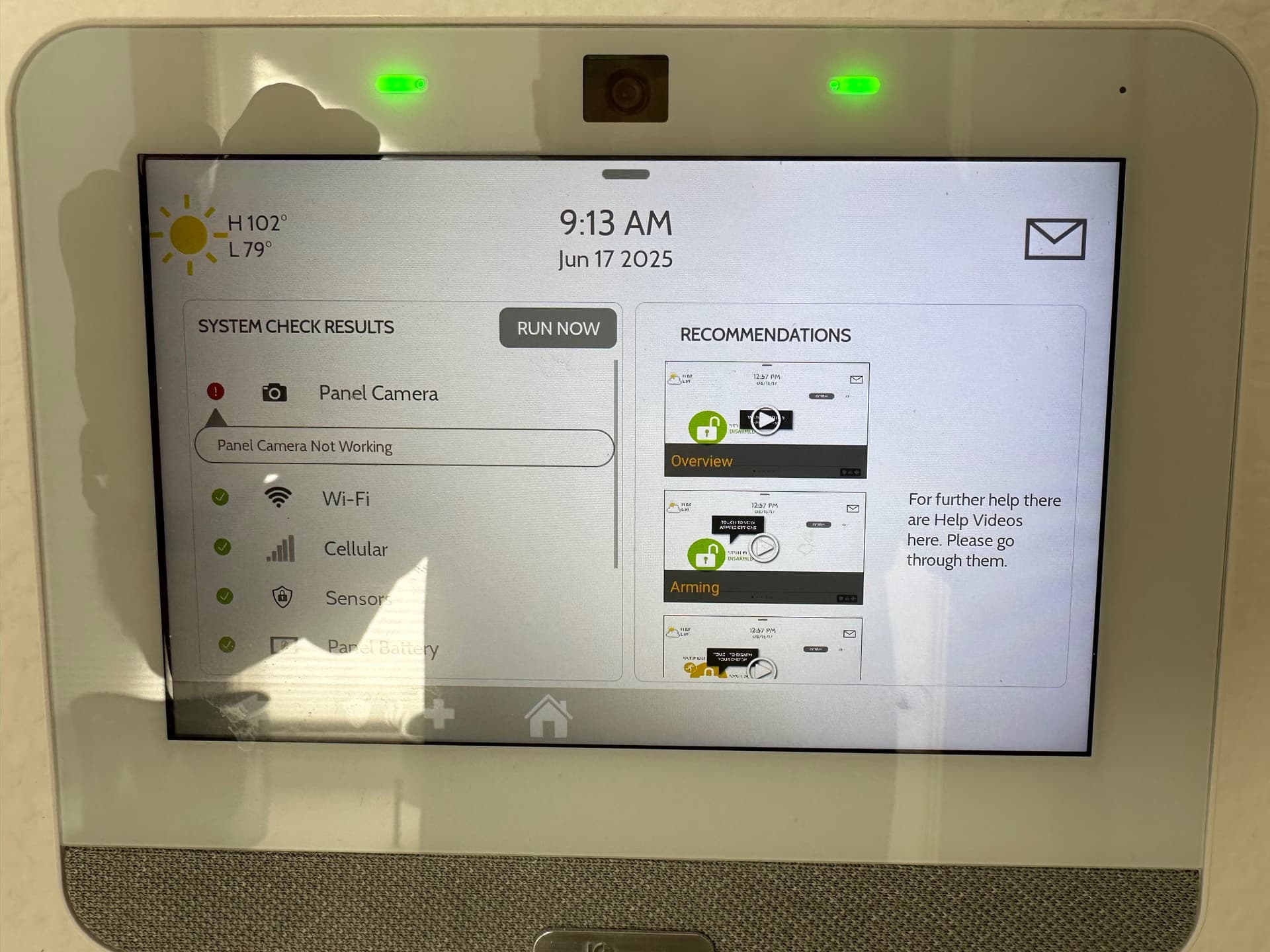

I upgraded to V4.6.1 the other day. I am experiencing the “Needs Attention” flag at the bottom right corner. It’s around the panel camera. This happened to another user here upgrading from another version as well. Is there a resolution to this? I have rebooted the panel and have toggled the camera on/off to no avail. Thanks in advance.
Where are you seeing the camera error? Does the camera work?
If you run a system test > Panel test, does the error go away?
Hi Tyler,
The error is persistent even after running a system test. Error says “Panel Camera not working”. Doesn’t appear to post any pictures when disarming the system. Never saw this issue until the recent update but did see that another user here had the same issue with prior release. I have a IQ Panel 4.
Hi tlp,
I think I was that other user. In my case the panel camera error would come up but the camera would still function in all respects. It was almost like a bogus alert. Doing “run now” on the system test screen would make it go away for a few days to a few weeks.
I just upgraded to 4.6.1 the other day so too soon to tell if it made a difference either way.
If your camera isn’t actually working I suspect it may be a different issue, as my camera always worked.
Unfortunately, “Run Now” does not remove the error. Never experienced this issue until I updated to 4.6. Completely related to the firmware update in my opinion. The main panel camera is no longer capturing photo events but my IQ Remote panel is.
Understood. I didn’t mean to say it wasn’t necessarily related to 4.6…. I only meant to say it doesn’t seem to be the same issue that I was / am having since the symptoms are different
Have you power cycled the panel, or tried any other troubleshooting to resolve?
Hey Tyler, I have power cycled the panel and manually reran the “Run Now” test. Camera works fine on the Remote IQ and images are visible on the IQ Panel 4 from the Remote IQ.
Fully power cycling and leaving the unit off for 10 minutes would be my first suggestion if that has not already been done.
Try that, if you havent already, then run a camera test. System Test > Panel Test > Camera, does it pass or fail?
If its not passing, or taking images, it may be hardware failure. I’m not seeing an active account with Surety, so I’m a bit limited in what I can see, or assist with directly. You may want to reach out to your current provider if you have one.
Hi Tyler,
Another Power Cycle from the panel was the ticket. Everything looks good and no more errors. Thanks for your assistance.
