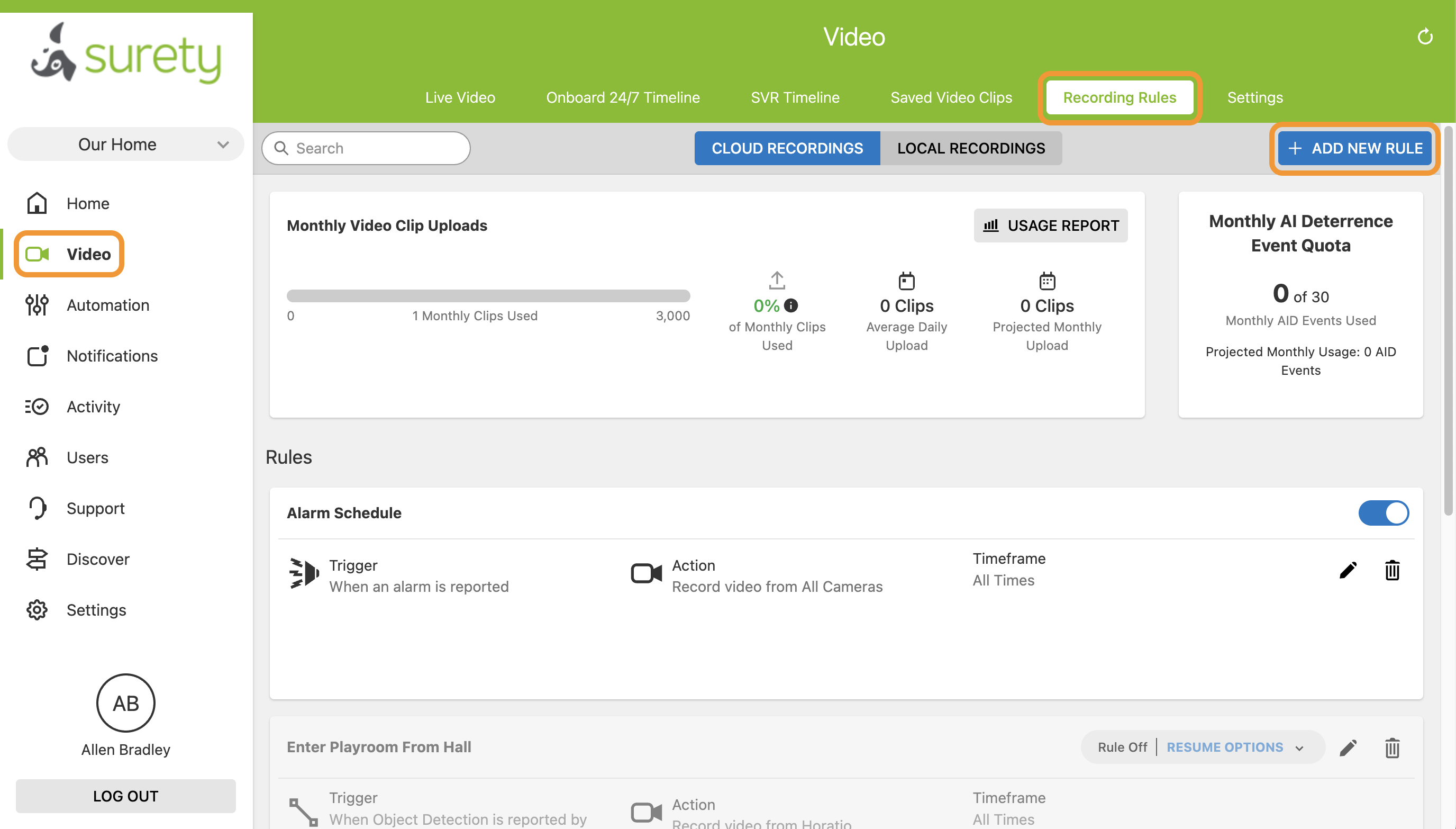

Video recording rules determine when a camera records a clip. Most recording rules can only be created and edited using the Alarm.com Website. The only exception is Video Analytics rules which can be created and edited using either the Website or app.
Recording rules can be viewed, paused, and resumed using the Website or app.
Note : For users with a security panel, an Alarm recording rule is created for each camera by default to record during alarms.
