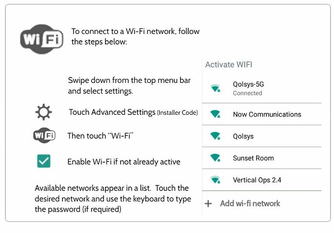

To connect the panel to Wi-Fi, follow the bellow steps.
At the panel navigate to:
  • Slide down on the Settings tray and tap Settings
  • Then tap Advanced Settings
  • Enter Master User (1234), Installer (1111) or Dealer Code (2222)
  • Tap Wi-Fi
  • Click Enable Wi-Fi if not already checked.
  • Select the desired network and enter credentials
