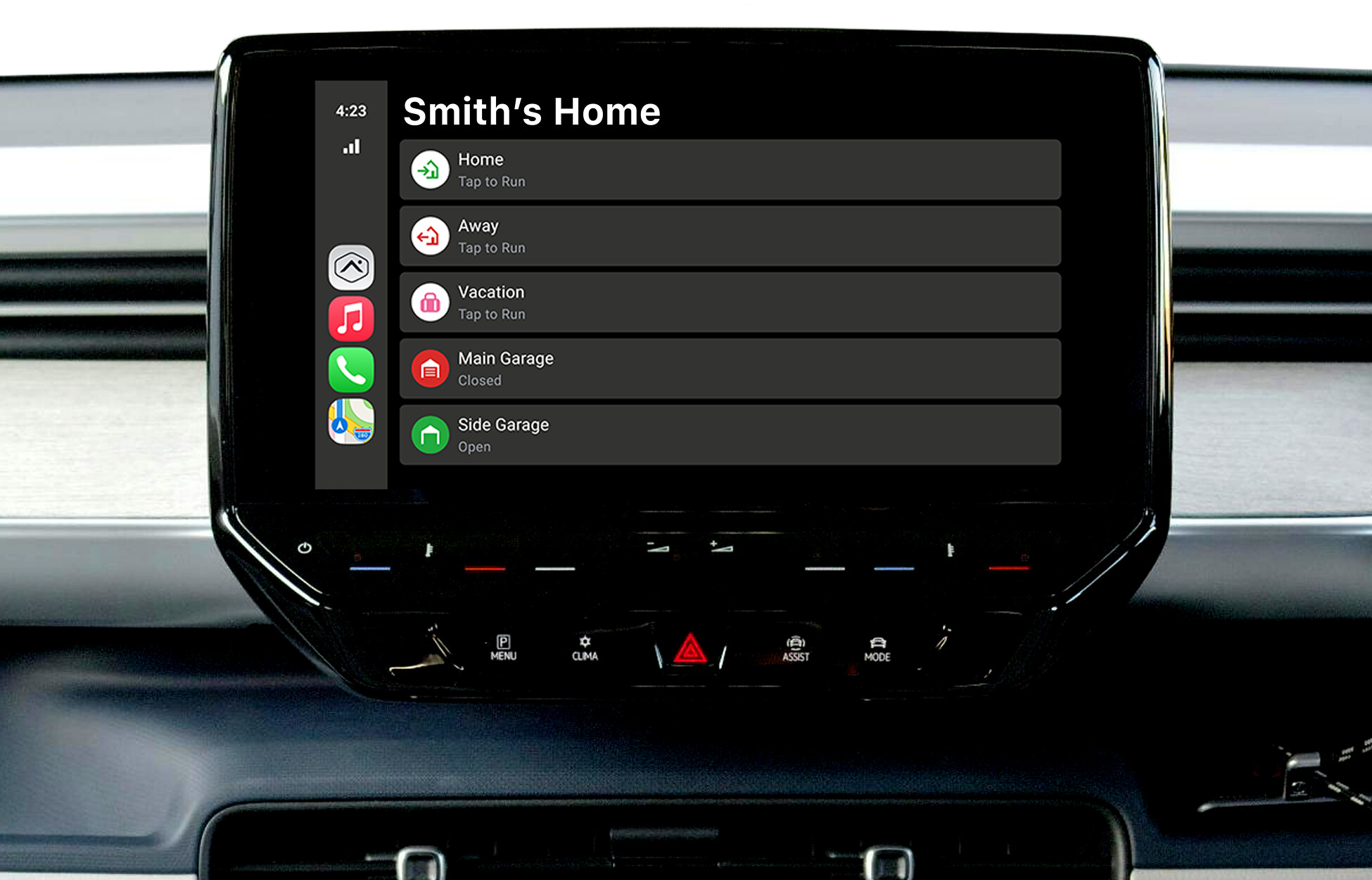

Alarm.com for CarPlay is now available. :partying_face:
Went to check it out and could not find it. Checked my carplay settings and the ADC icon was not showing to add. Is there a setting the actual ADC app I need to turn on as I could not find that either
Have you updated to the latest Alarm.com iOS app version 5.10.1? It’s in that update.
That did the trick. Thanks
Its a bit useless. It says I have devices not compatible with Carplay so the only things I can do is arm the alarm. NO Garage door or lock control. Went to the settings to try and add those and its not showing as able to add.
