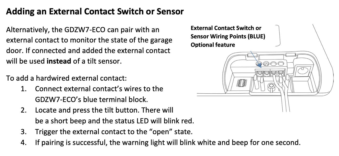

I installed a reed switch to the device and it works Great and eliminates the tilt senor and another battery powered wireless device. It works perfectly and was easy to install except that when the garage is open it says closed and when closed it says open.
This is because you need a “normally open” reed switch and I think they normally come normally closed.
You can get them here for 8 dollars Amazon.com: 2Sets Magnetic Reed Switch Normally Open Closed NC NO Door Alarm Window Security/Magnetic Door Switch/Magnetic Contact Switch/Reed Switch for GPS,Alarm or Other Device,DC 5V 12V 24V Light : Electronics

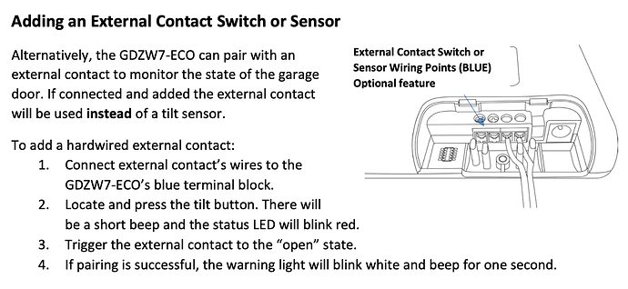

I haven’t used the external contact input myself but from the manual I get the impression that you might be able to use either NO or NC.
In step 3 when it says Trigger the external contact to the “open” state, I suspect that means when you program it, if you have the terminals connected (closed) then it will work as a normally open sensor, and if you have the terminals disconnected (open) then it will work as a normally closed sensor. Not sure but that’s how I interpret it.
It would be unusual for a door contact input to be normally open because most door contacts are normally closed. But anything’s possible.
Update: The external contact input is normally open (NO).
I had the reed sensor wired up. I then plugged in the unit and did the programing. This would seem to align with what you instructed. It didn’t work. will have the normally open sensor tomorrow and will report back
According to my theory, if you had the sensor wired up and closed when you programmed then it would be programmed as normally open, in which case switching to a normally open sensor would work.

I spoke to Ecolink about this and you are correct. The external contact input is normally open (NO) and not programmable like I thought. That’s unusual but it sounds like you have the solution arriving today.
Confirming that using a Normally Open reed switch works and eliminates the need for the tilt sensor making the setup more responsive and reliable. Installed it today
