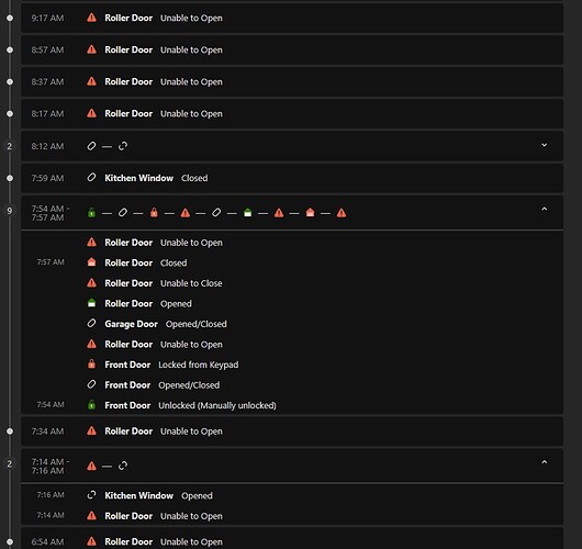

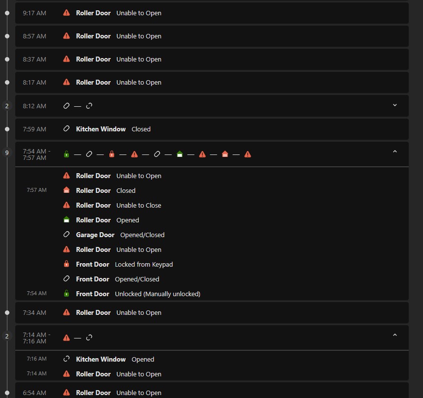

Also, in my alarm.com activity screen it shows many errors for ‘Unable to Open’ & ‘Unable to Close’. Like it’s continually trying the failed activity.

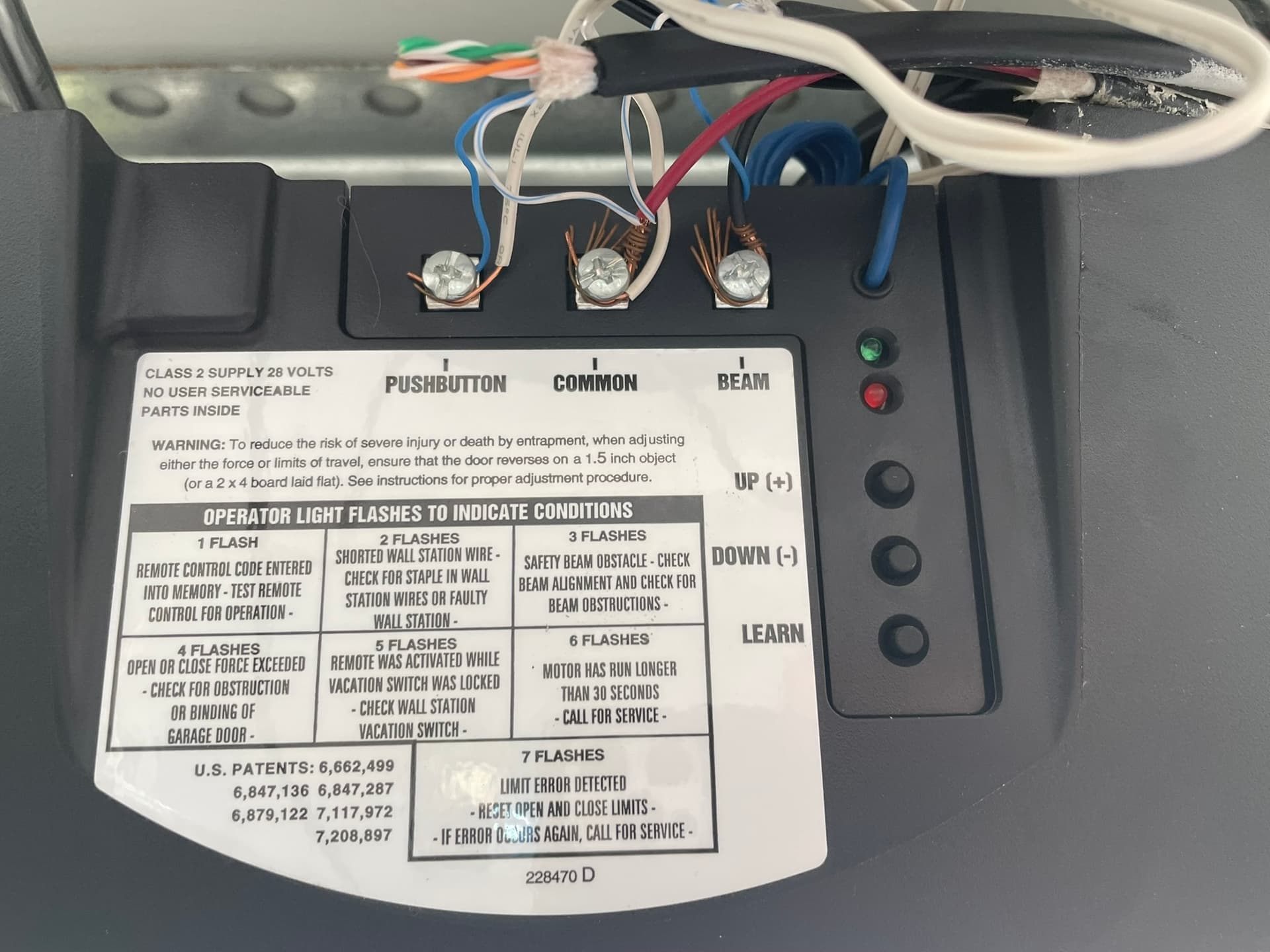

The GoControl is wired into my garage motor ‘pushbutton’ & ‘common’ connectors.

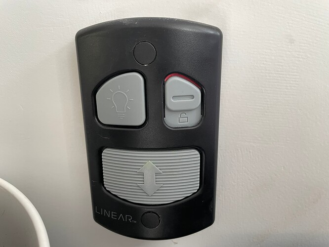

What is the model of the overhead controller and what wall-button are you using? Can you submit a photo? The Linear Z-Wave Garage Door controller has been found not to work with some powered wall control panels that constantly draw power from the GDO. Such as those with lights and/or LED screens.

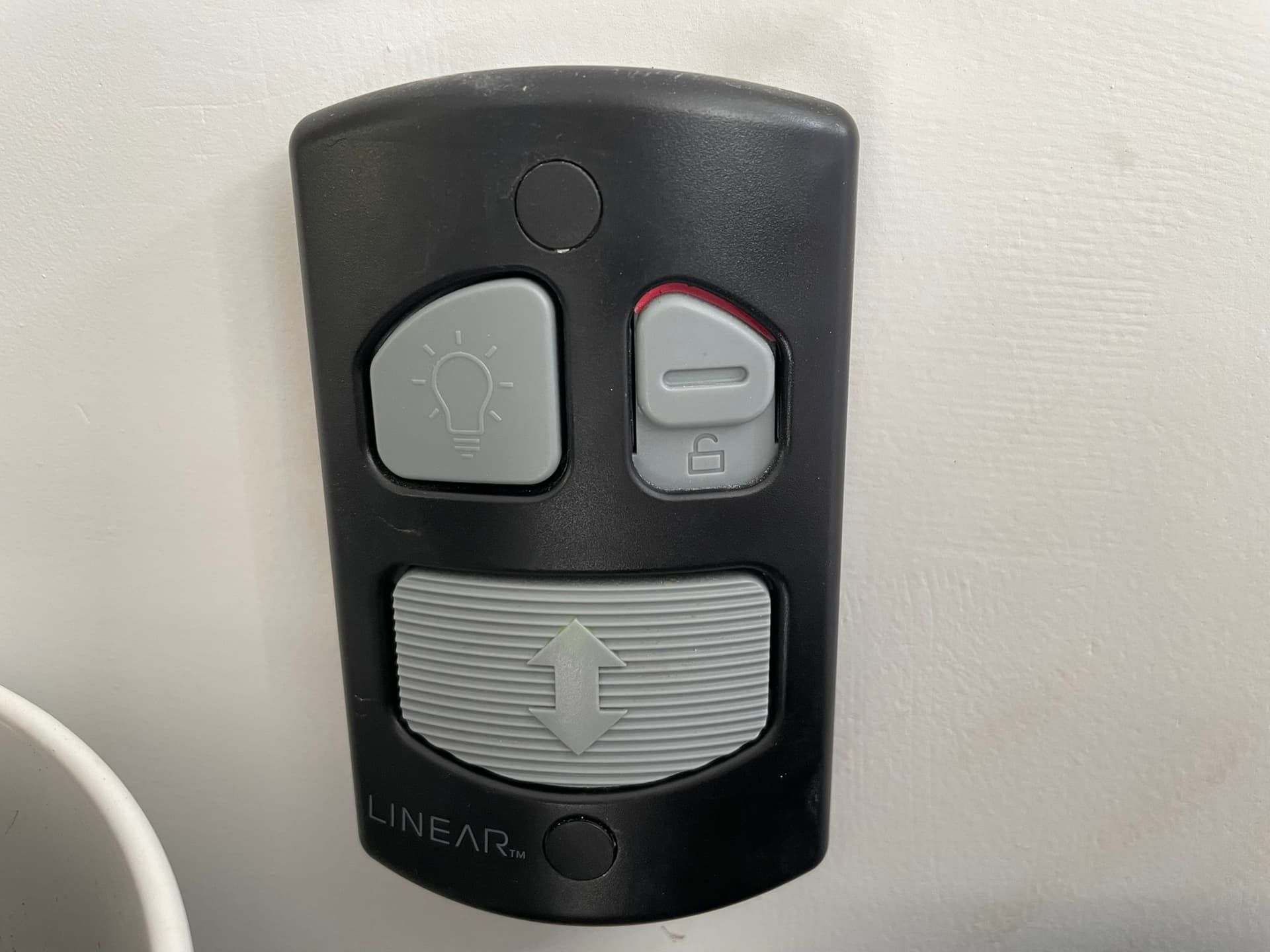

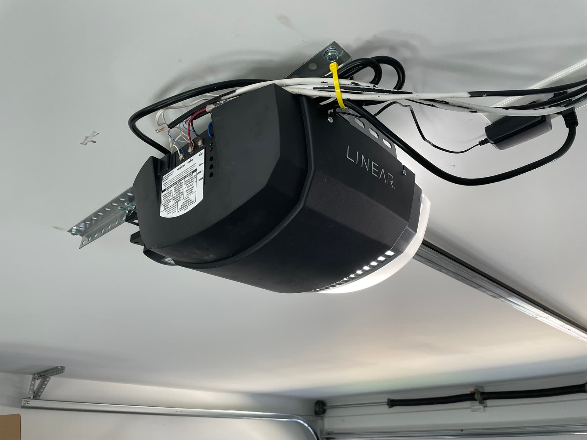

It’s a Linear overhead controller, there’s a number 228470D on the tag not sure if that’s the model. Will attach some photos of overhead & wall button.
I’ll keep testing it and see how it behaves (it worked up/down twice ok just now).
Thank you for that information.
There shouldn’t be any compatibility issues with the overhead or the wall button. Looks like you have the Linear LDCO800 overhead.

Hi, looking into this, I see examples in history where the system reports that Garage Door was unable to open. The alarm sensor 21, also labeled Garage Door reports open and closed, but the Z-wave garage door controller does not see the door open at times.

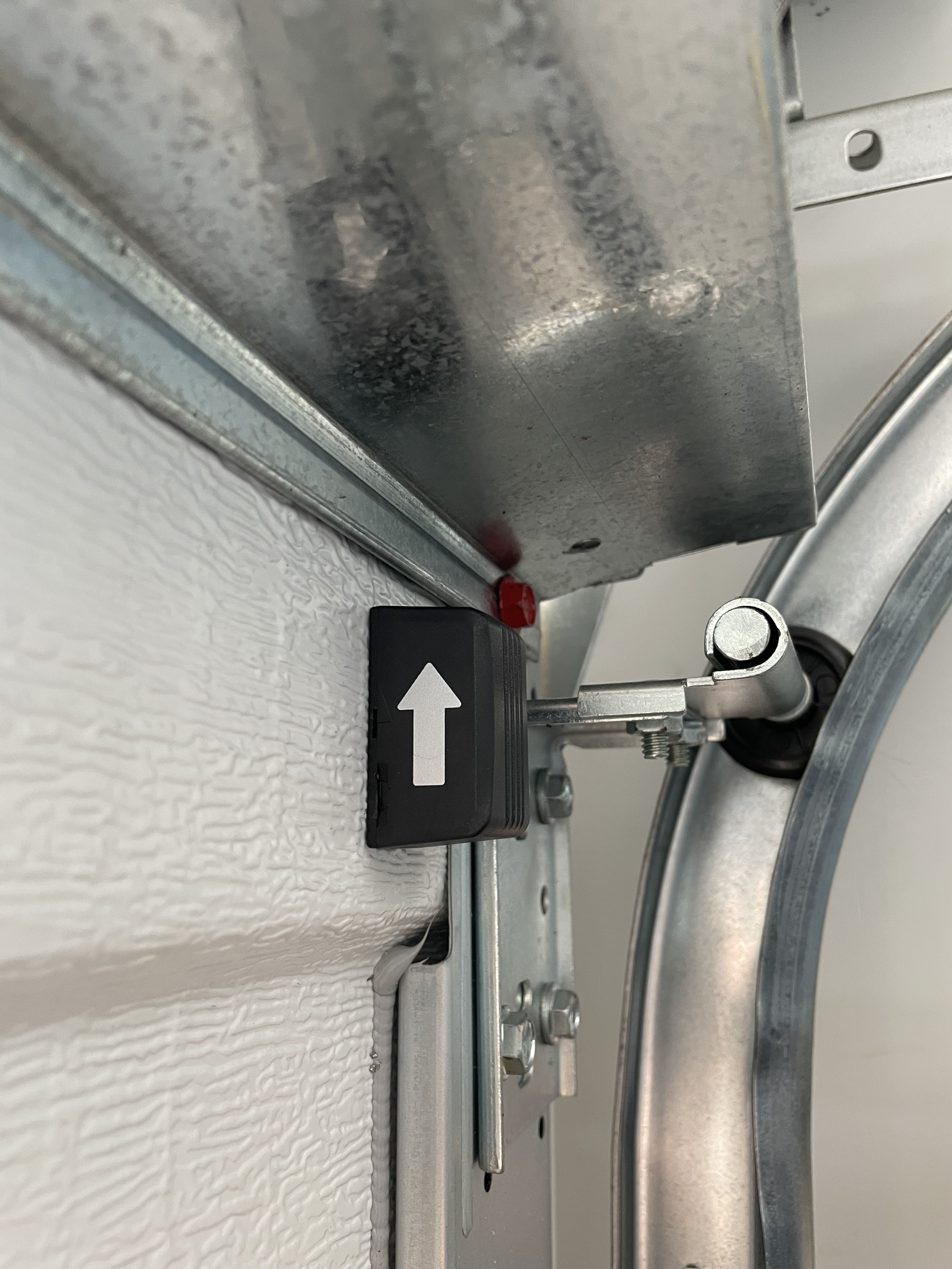

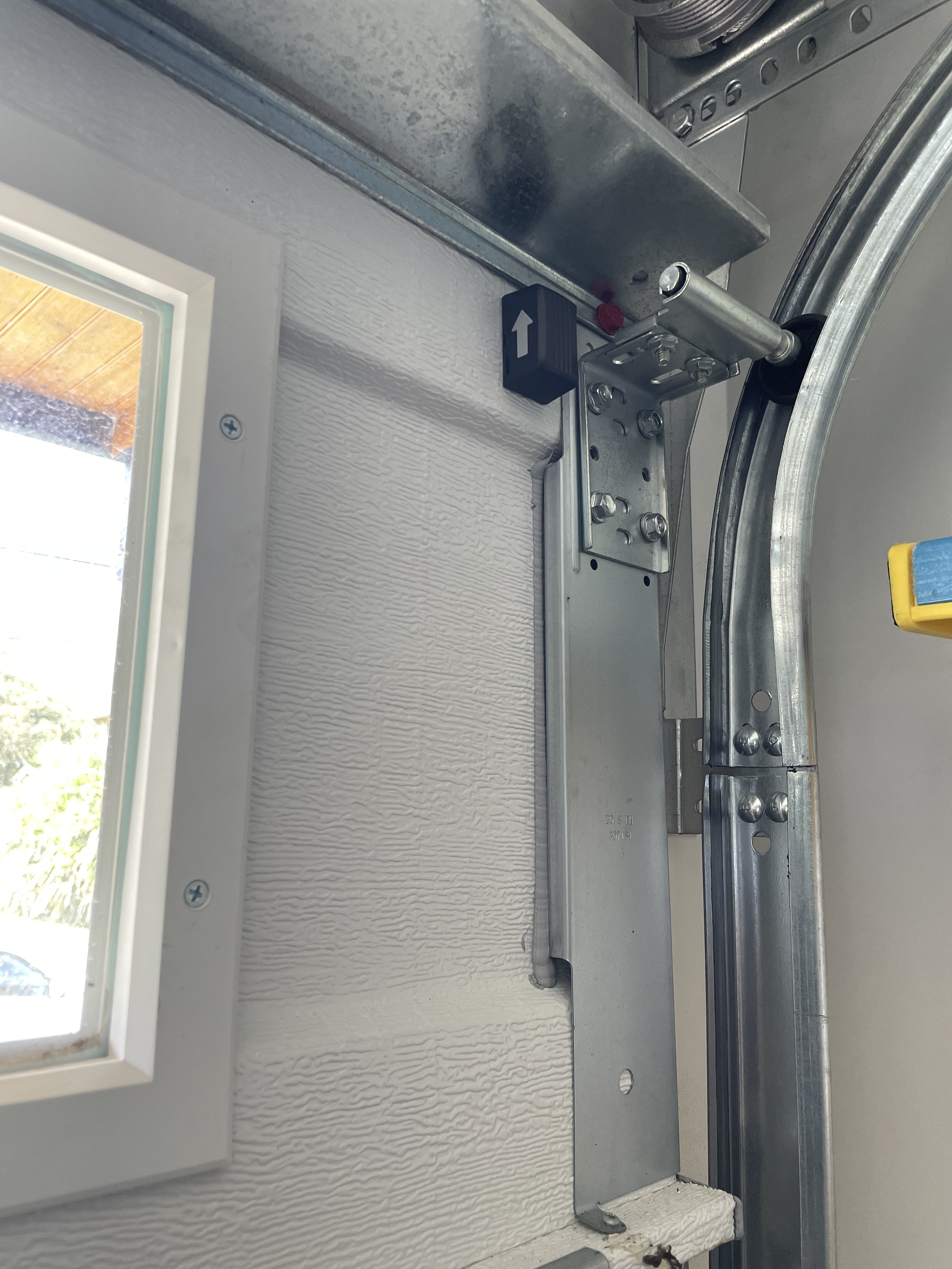

Can you post a photo of the tilt sensor that came with the GD00Z-8 ? A close up and a photo showing the general location on the door will help identify any issues.
Hi there, here’s picture of panel door sensor, also not to be confused with a regular door sensor called garage door (probably better if I rename that in hindsight).
I think the panel door is consistent in alerting me when it opens or closes - but I’ll keep a closer eye on it.
Also, when I tried to operate the panel door the warning flashing and beeps did operate but the panel door did not open.
I guess my next step will be to try the wire connectors again and make sure that contact is good?
Yes it would be good to check the wiring connection to be sure. It might be good to cut the wire back, expose fresh wire and reconnect.
Based on the history I saw in Alarm.com though I would expect the tilt sensor may play a roll in this issue.
I would recommend replacing the battery in that tilt sensor the Z-wave opener uses. This is a possible cause of unexpected issues.

Since then I’ve also cut back some fresh wire & re connected the terminals just to be sure. I think it’s still not working everytime, but I was able to open & close it just now.
