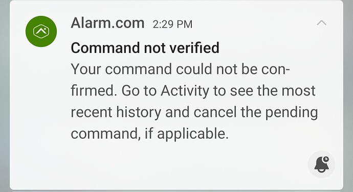

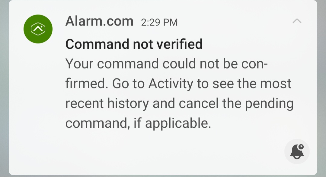

What is the time on the latest notification? Can you grab a screenshot of that notification and post it here?

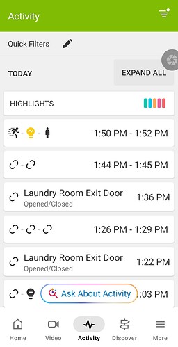

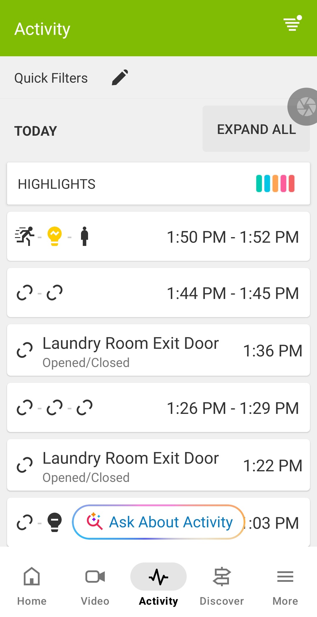

Here is the latest notification and the activity timeline from the app.

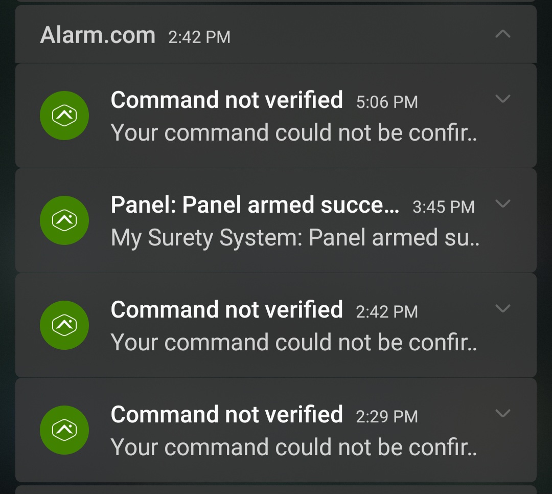

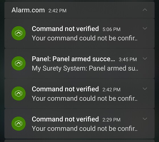

In case it helps, here is an additional screenshot of more notifications
