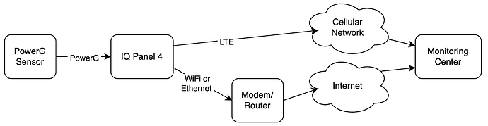

To sum it up a bit, assuming you are using PowerG sensors and dual path (internet + cellular) communication from the panel to the monitoring center, it looks like this.
The PowerG link is pretty secure thanks to frequency-hopping spread spectrum (FHSS). It’s unlikely that an intruder can interfere with it.
Communication from the panel to the monitoring center is dual path - signals are sent simultaneously through both communication paths. If either path is working then the signal gets to the monitoring center.
The Internet path either uses Wifi (what most people use) or wired Ethernet (if you have an IQ Ethernet Card). Wired Ethernet is arguably more secure because it can’t be jammed from outside but it can still be blocked if the intruder can cut your internet connection from the outside.
