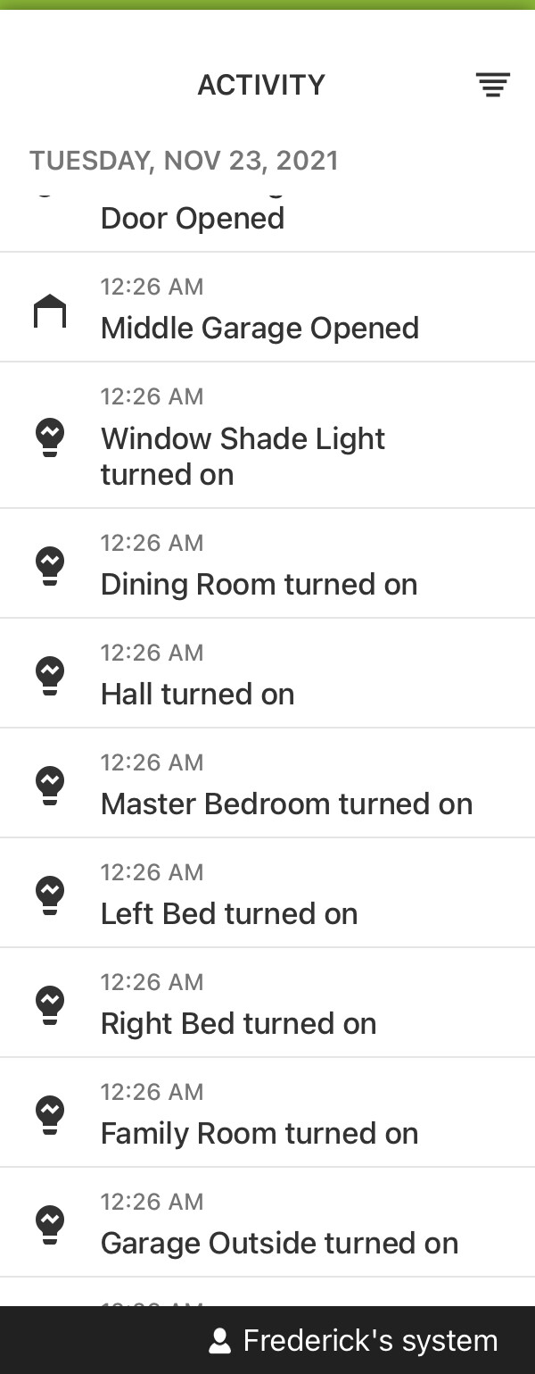

Here is the history.

Why we’re all of the other lights and devices turnes on? We do Ave a rule that turns those on when the garage doors open a night, but am wondering why hey are not occuring after the garage door opened
They turned on because you have a rule turning them on when the door opens. All those events were reported to Alarm.com essentially simultaneously, and the panel processes this rule locally. It would run even if you had no ADC connection.

What I can confirm from system history is that no data was sent through Alarm.com at that time. There was no command to open the door. Those events in history are the panel reporting the activity to ADC, and it would do so regardless of the method of opening the door, since tilt sensors are used.
That means garage keypad control, wall-button, car-fob, key-fob entry, or services/products like Homelink etc., would result in the exact same activity and rule activation.
