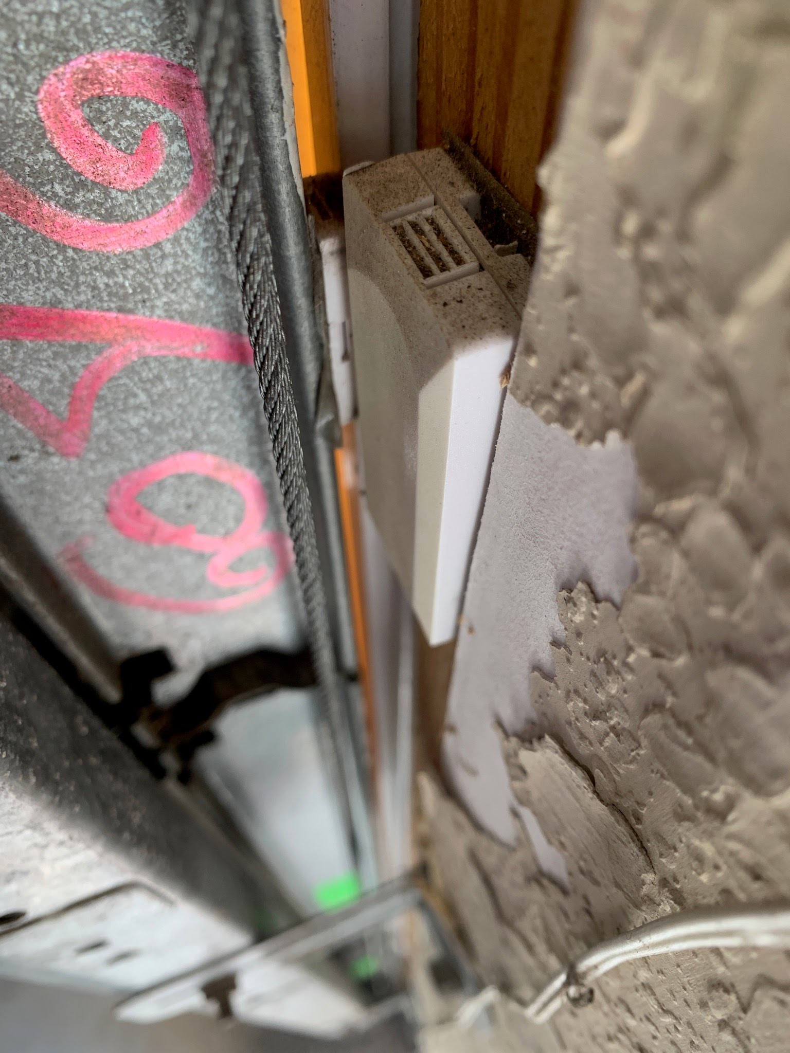

I discovered that it takes barely any tilt for the tilt sensor to register open. So now I can see how wind could give you false alarms. Also the foam panels of garage doors are flexible and over time may not be completely straight
I think it’s best to mount the tilt sensors on the metal portion of the doors. It’s stiff. I tapped on various places and on some sides it moved more than others so I mounted on the highest point, on metal that moved the least.
Time will tell, but though users should know it really surprised me how little the tilt sensor has to move to show open.
