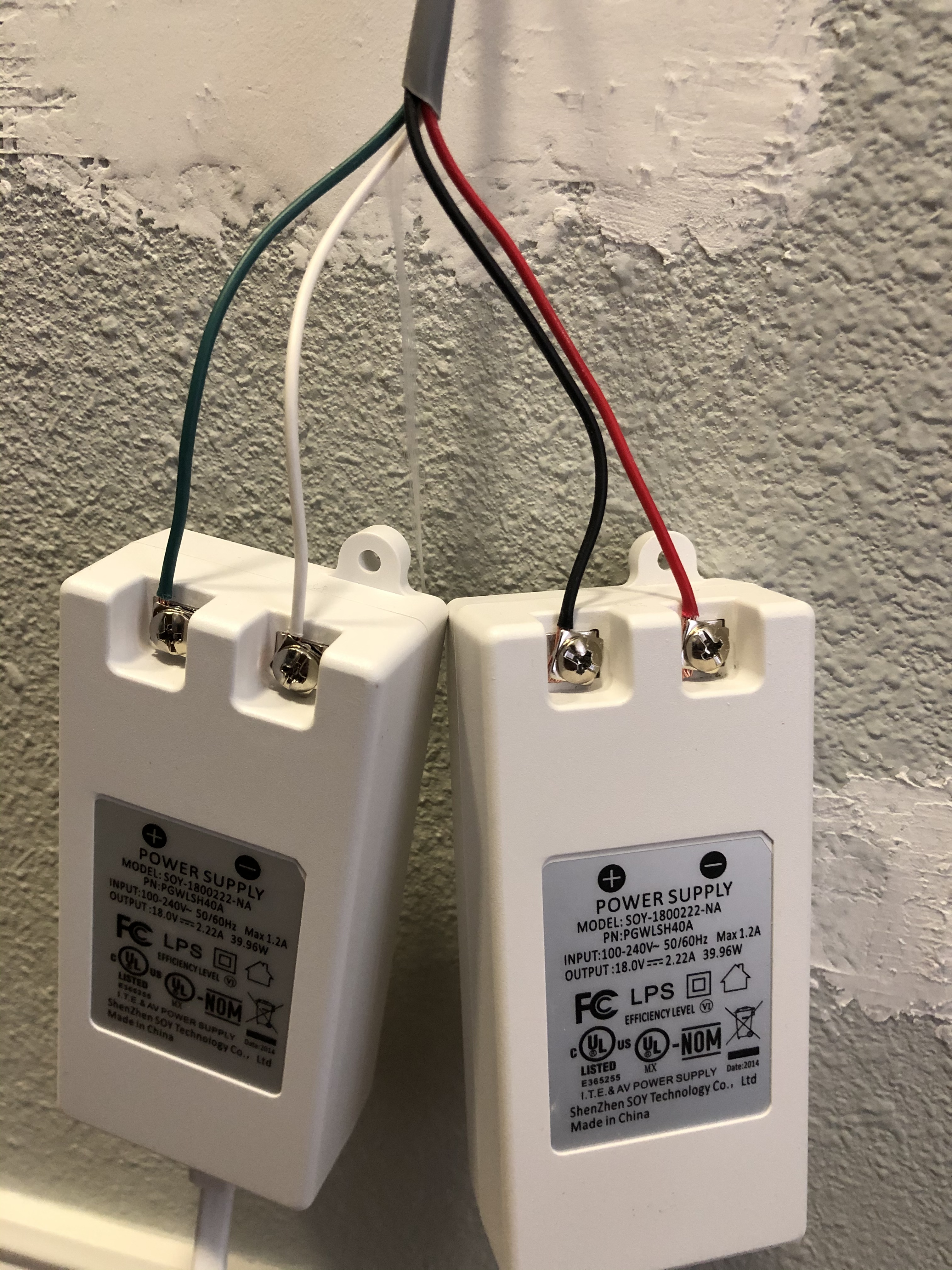

It only matters if they are flip-flopped at the other end, but I want to call it out because it is not how wires are typically used:
You currently look like you have the red wire connected to the DC negative terminal. Generally you would use the red wire for the Positive terminals. This would be a problem if you have red connected to Positive at the transformer end. Can you confirm?
The transformer, not the battery.
Look at the 18VDC terminals. Red is connected to negative on the board. If the transformer has red connected to positive that would be a problem.
Sorry yeah I just realized what you meant. Yes I had four different colored conductors I arbitrarily used for each of the two translators
Ok, yeah of course the color doesn’t matter, can be arbitrarily chosen, just wanted to make sure it is the same at both ends.
How long is that power cable?
