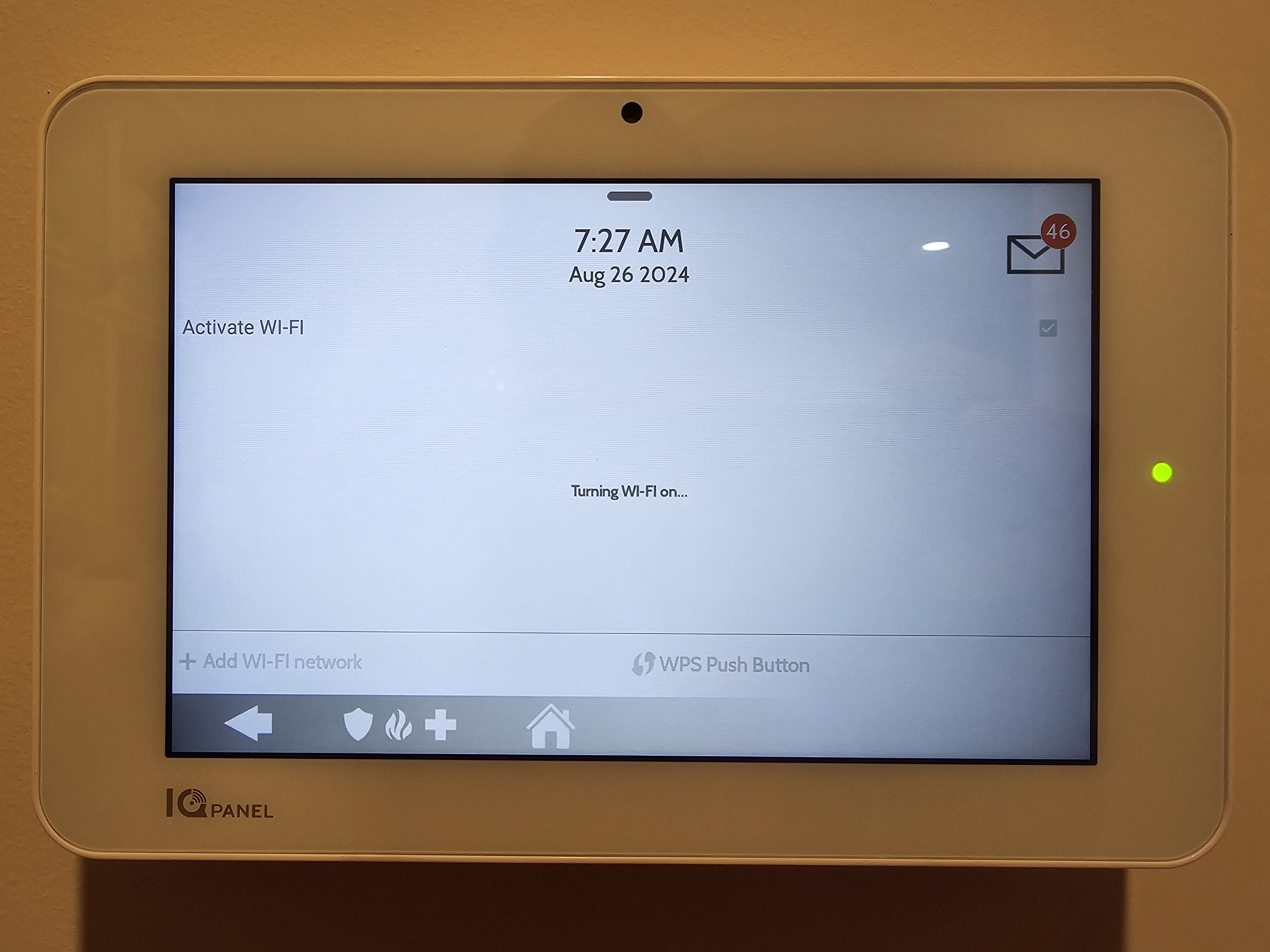

Onboard Wi-Fi will not enable. What could be wrong?
What happens when you try to enable it? Any error message? Or a pic?
What is the firmware version of the panel? You can update the IQ Panel 2 firmware via SD Card. This is likely necessary to resolve this issue.
Hello, and thank you for the advice. The current software version is 2.6.1. I downloaded the update and put it onto an SD card, but when I log into the panel and press on the software update button and then update via SD card, it says I need to mount the SD card. So, I go to the main settings page and then SD card and press mount SD card, but it doesn’t mount.

That was it! Well, it’s upgraded to 2.8.1 now. The onboard Wi-Fi still won’t enable.
It sounds like you may be dealing with a hardware issue since updating the firmware via SD card didn’t resolve the Wi-Fi problem. One option you can try is performing a master reset on the panel. The master reset won’t revert the firmware, so you don’t have to worry about losing the update, but it will erase all programming and settings on the IQ Panel 2.

After the update to 2.8.1, the cellular communication function no longer works, so there is no connection between my panel and the monitoring service. Also, the Wi-Fi remains non-functional, as well as (I suspect) other functions.
I have an ADT technician coming out on Friday, so hopefully they can fix it without replacing the panel. Otherwise, I will likely go with the IQ Panel 4 as the 2 and 2+ are either being or are currently phased out.
Your provider will likely try a factory reset, it sounds like it may be hardware failure but a reset is generally recommended as a step to be sure.

Yeah. I just did a factory reset. Still no cellular or Wi-Fi. ![]()
Replacing the panel when it arrives.
