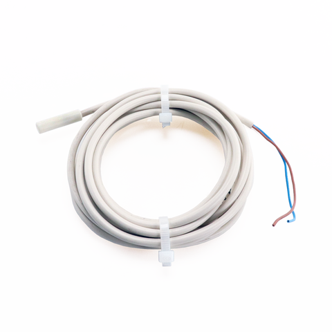

Hi, I’m hoping to monitor the temperature in a garage freezer, such that I can get a notification from Alarm.com on my phone if the compressor ever fails and the temperature exceeds some programmed threshold. I have an Qolsys IQ 2 Plus panel. It seemed that the PG9905 temperature sensor might be the best choice for this application, especially when used with the optional external temperature probe.
However, I’ve read the PG9905 is limited in that there is no way to receive high/low temperature notifications from Alarm.com when using this device. Is this accurate and current? If this is the case, is there a less-obvious benefit to using this device that I am missing - would there be some local notification at the panel, instead?
Another approach seems to be using a ADC-S2000-T-RA remote temperature sensor for this purpose, but then I’d be forced to place it directly in the freezer (i.e. no external temp probe), which I imagine could exceed recommended environment ratings at worst, and wreak havoc on battery life at best. I haven’t found any recommended operating temperature for these RTSes; does anyone know what they are? Does anyone have experience in using these for freezer temp monitoring applications…?

The PG9905 with a temperature probe would be the best way to monitor for temp inside, described earlier in the thread. As long as you have firmware 2.4 or later you can adjust the temperature threshold to monitor for in sensor programming.

Sorry for the late chime in. I think the best solution for you would be the PG9905 with the additional probe. You could drill a hole into the fridge and insert the probe. I tested it with the IQ2+ and you can indeed set you high and low alerts. You can set it to get a notification for a high or low of your set point and it will notify you if the compressor fails. I tested it to trigger an outlet which I wasnt able to do.
Thank you all for your thoughts! I went ahead with the PG9905. However, at this time I have not purchased the temperature probe. I’d definitely like to avoid drilling a hole in the freezer, if possible.
Is there really a compelling need for the external probe for this particular application (freezer temp monitoring)? Placing the PG9905 itself inside the freezer yields a solid signal to the panel, and the indoor operating temperature of the device itself is rated -4 degrees F to 122 degrees F. I would think that the probe would be meant more for outdoor applications, no? I understand that putting it in the freezer may result in diminished battery life, but are there other considerations I’m not thinking of?
The probe is meant to be used in applications like observing the temp of a freezer. Per the instructions, when using the temperature probe, the sensor needs to be mounted outside of the freezer.
Placing the sensor in the freezer is likely going to build up condensation/ice on the sensor which will likely damage the unit in addition to affecting signal strength and battery life.
Instead of drilling, you may be able to place the probe between the freezer door seal and the freezer itself. Depending on the seal this may work as an alternative to drilling into the freezer.
