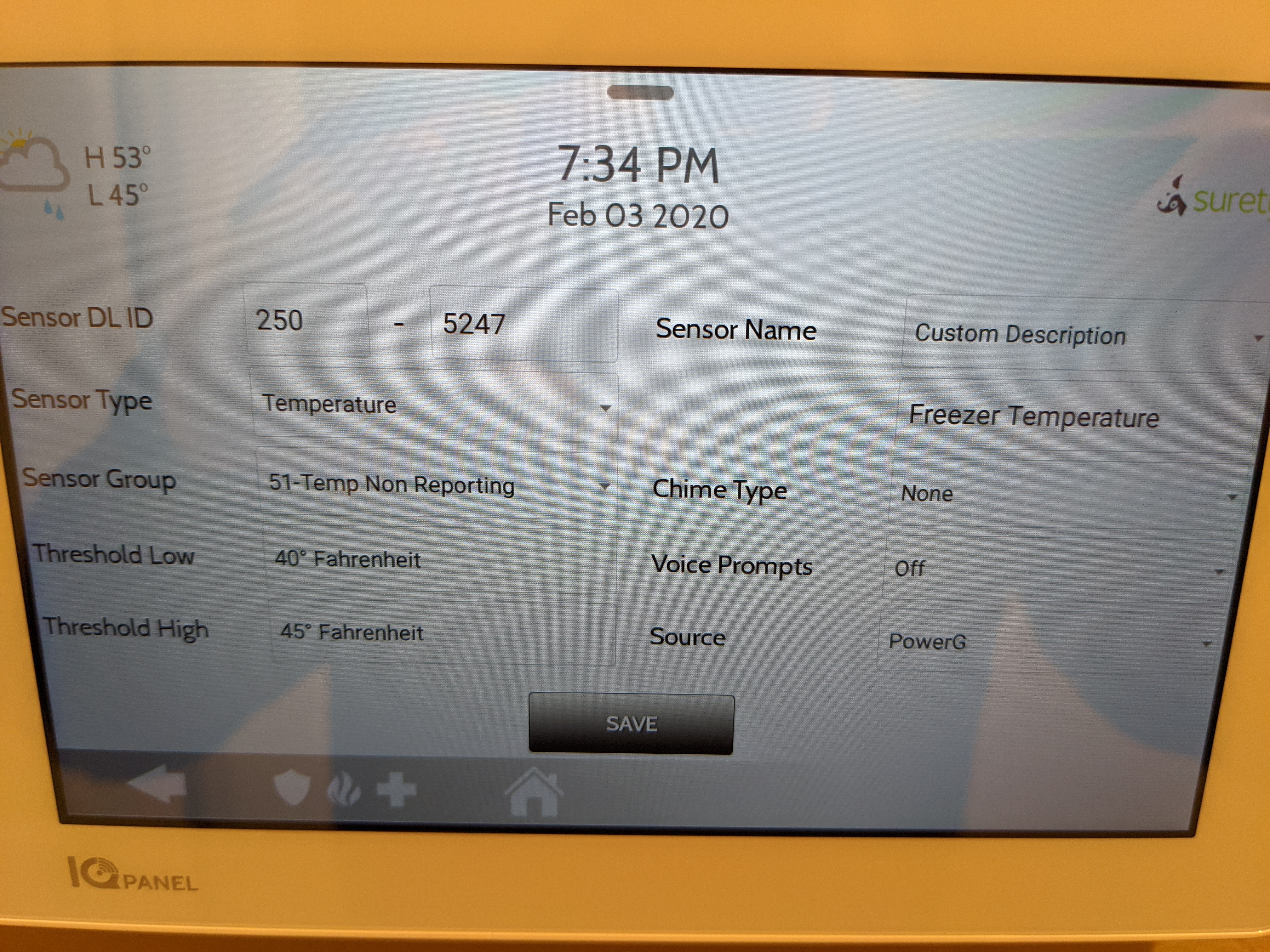

Another issue: I have not been able to get temperature events to generate any kind of ADC notification. I get these events reported to the panel, but not via ADC. The sensor is in Group 51, and my IQ Panel 2 Plus has firmware version 2.4.2 installed. Per the firmware 2.4.0 release notes: “…High/Low threshold reporting for Group 51 now supported by Alarm.com”.
I have tried setting up the notifications two different ways, and neither of these works despite repeated attempts:
New Notification | Temperature | Temperature Alert | When the device detects a temperature: Above [TEMPERATURE] | For the selected devices: [Freezer Temperature]
New Notification | Standard | Alarm | When Alarm Type Audible [CHECKED], Silent [CHECKED] | Is reported by Specific Sensor: [Freezer Temperature]
I’m thinking that the former approach is the correct one, as the second one is premised on an alarm condition, and since Group 51 is “non-reporting”, I gather that this does not qualify as an “alarm”. Right?
coo30, it seems you were able to get this to work, per your post here. Does it read to you like I’m doing anything differently…?
The panel was definitely at 2.4.2 prior to adding the sensor. I added the sensor on Wednesday, January 29, and have been intermittently testing with it every day between this day and as recently as Saturday, February 1 (maybe even Sunday, February 2).
I’ll be in a better position to repeat these tests and take requested pics either later tonight or tomorrow.
Ok, I retested last night with no different results, so as to supply screenshots depicting configuration and timestamps (this is Eastern). If it helps, the corresponding notification rule I am testing with and expecting to trigger is named “_Freezer Temperature Alert (40-45 dF)”.
Thank you for the photos. I can confirm that there is no related event in Alarm.com history, so it is not an issue with notification, rather with reporting.
I am sending this info to Qolsys to see if we can get it replicated and resolved. It is likely a reporting difference between what the panel is sending and what ADC expects.
