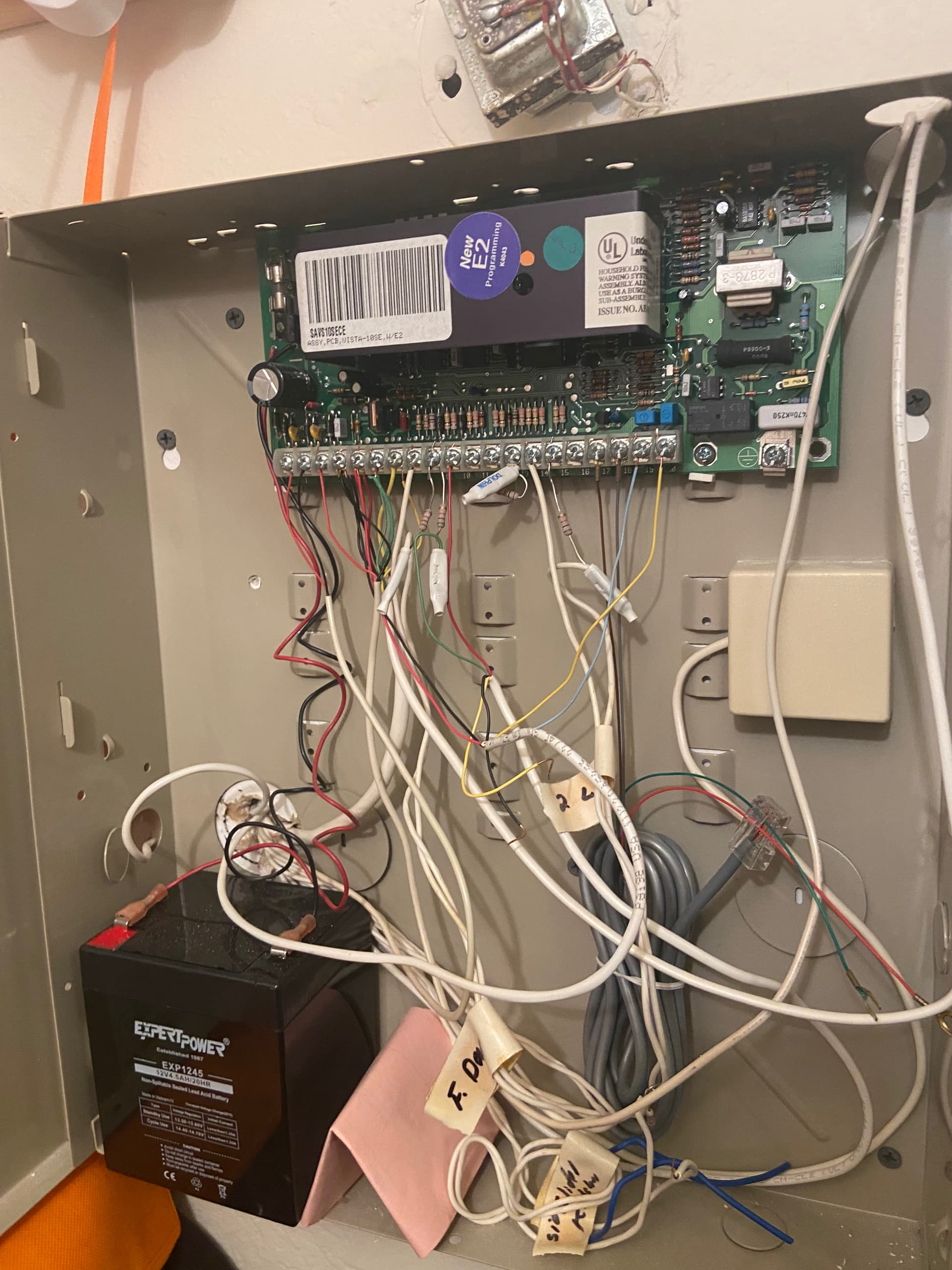

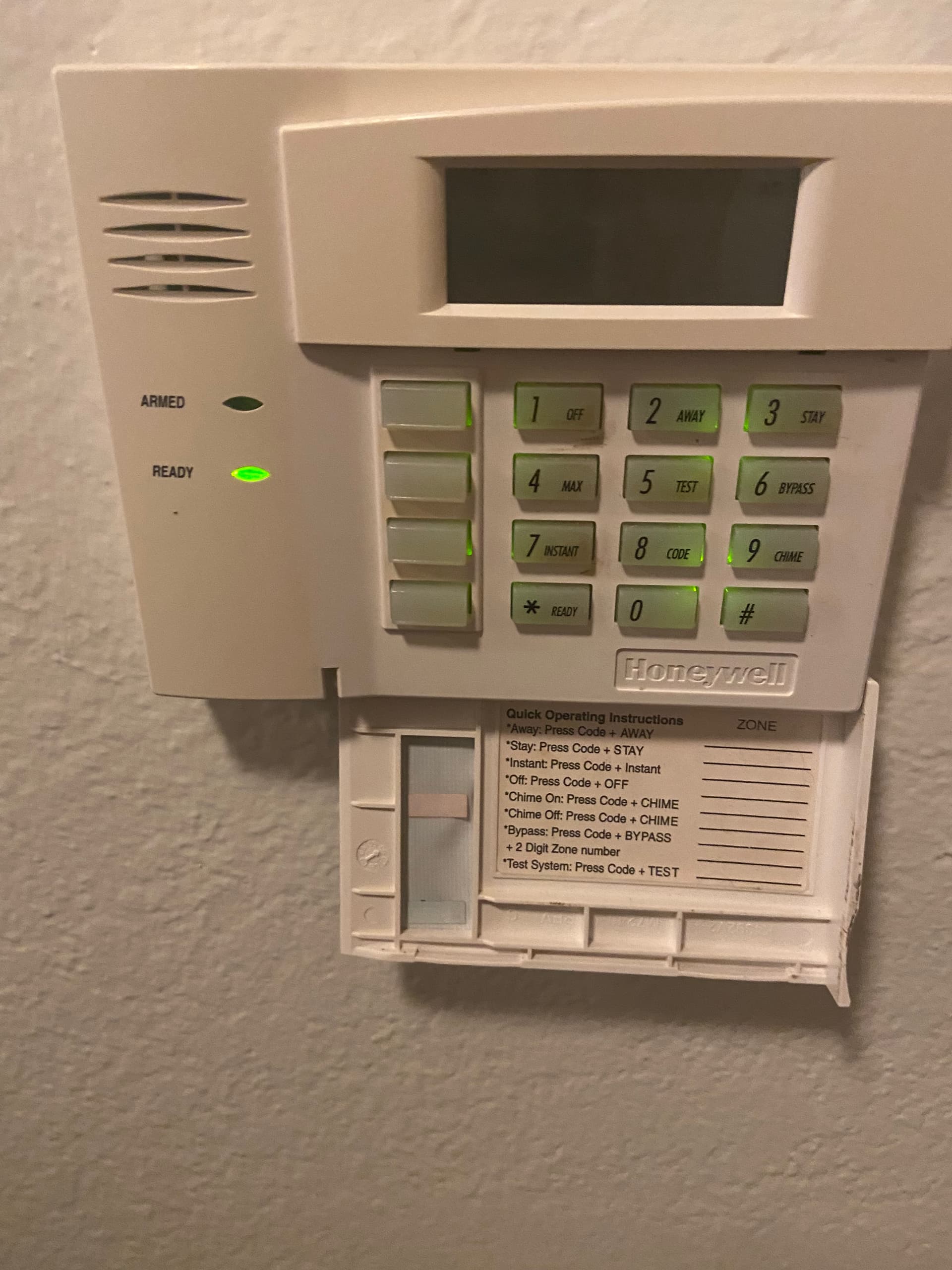

Hi - I need an alarm system monitoring. My home i purchased came with the below and I guess he used to use ADT. I have no idea how to start with Surety as im not very DIY. Can I sign up with service using this, or do I rip it out and install something I buy here? Im a complete newb so any direction would be helpful Thank you
That system is a Honeywell Vista 10se, and is not compatible with Alarm.com or service through Surety.
If you wish to use Surety for service, you will need to replace the system. We recommend using a Qolsys system; however, you can also purchase an Alarm.com compatible system elsewhere and use it with Surety.
You can find the systems that we sell here on our online store. In this case, I’d recommend using an IQ Panel 4 along with a hardwire to wireless converter like the IQ Hardwire PowerG to reuse the existing wired sensors or using an IQ Pro.
