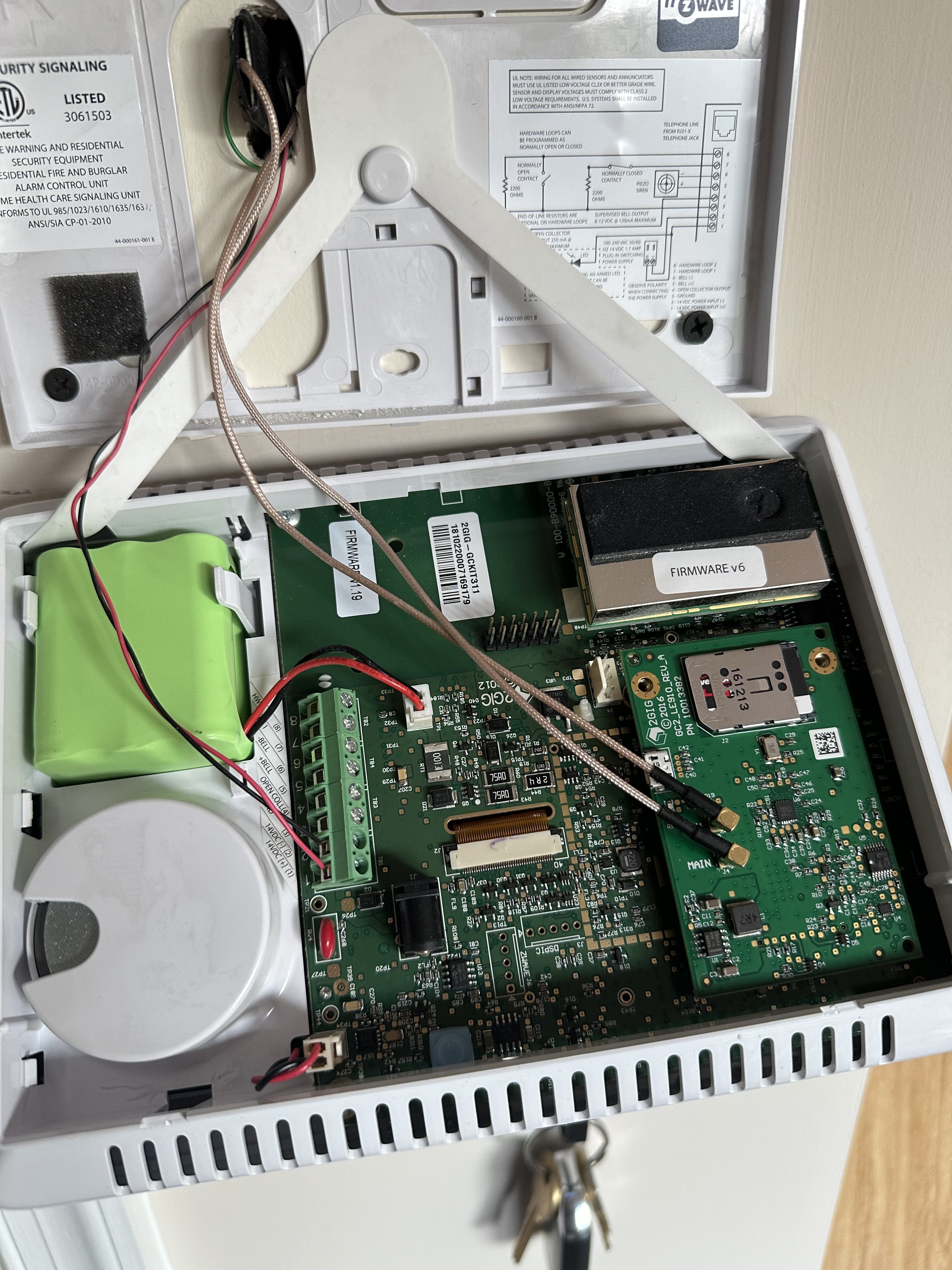

I restarted the system and still getting the radio transmission issue. It’s not getting that any of the sensors are triggering. Including a photo of the inside of the panel
Did you remove and reseat the transceiver? That is the silver colored brick in the top right in your image of the panel. It has the label that reads firmware v6.
Power the panel down completely, disconnect that internal battery pack too. Then remove the transceiver and reinstall it.
Just did that and it’s still giving me the same issue. The sensors were triggering up until 9/10 which is when I got access to the panel via the installer code from the previous monitoring company. It seems unlikely there was a hardware failure the same day.
