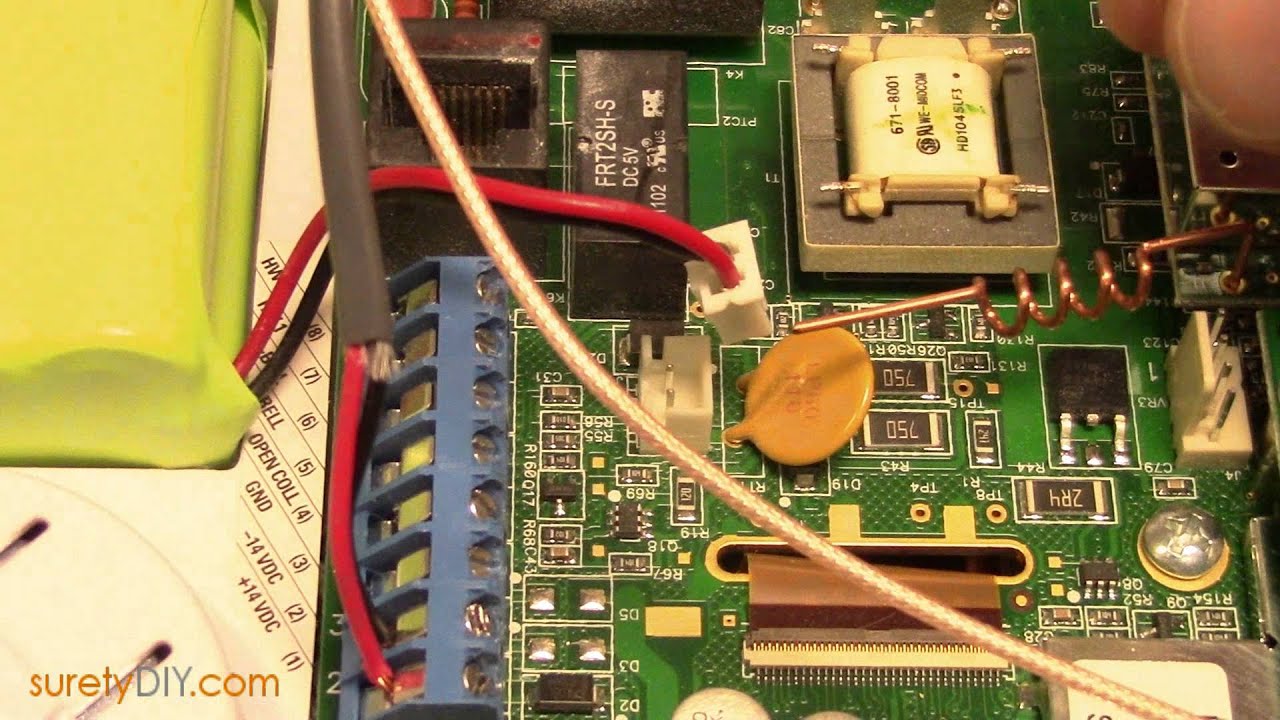

Was the panel powered down completely when you made the swap?
If so and it still has the same issue, double check the pins are inserted correctly for the transceiver. If all looks good, unfortunately this means the panel board itself is not able to see the receiver connected. A factory reset of the 2GIG panel would be the last step to try.

Yes, if successful it means you would need to reprogram zones. Below is a video on the reset process.
