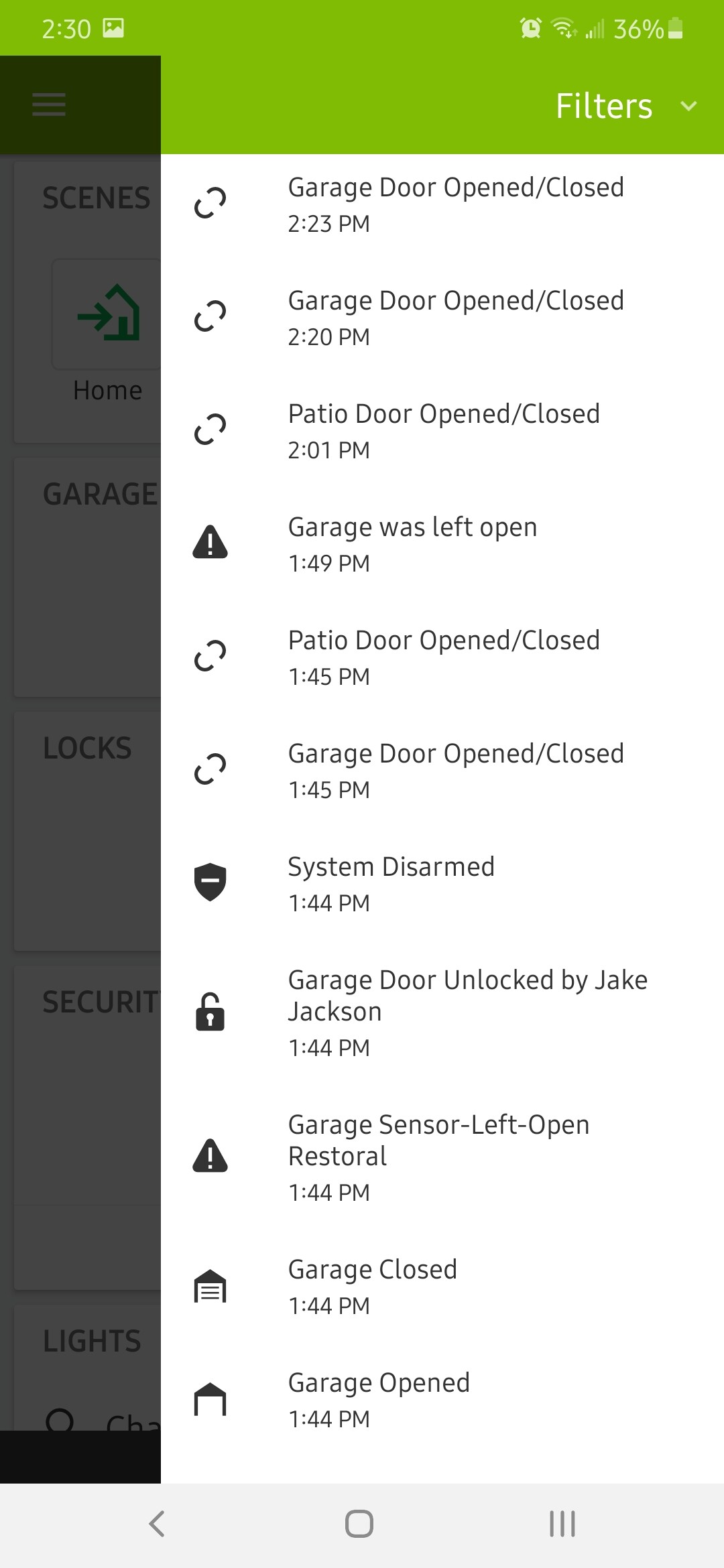

The last couple times that Ive come home, Im getting messages that the garage door has been left open after 5 minutes (my rule). Im opening it, pulling in and then closing it from the wall control. Adc is seeing it open but not close. Im using a liftmaster gateway with a compatible opener. If I go back out there and open and close quickly it updates. Or if I send a close command even tho its already closed, after a minute or two it updates. Anyone else have this problem?

Its the 828lm and a myq chamberlin opener. Theres no tilt sensor. This morning it worked, but I usually open the door and start my truck and idle for a second before leaving. It just seems when I pull in park and close with less than 30 seconds of open time, it messes up
I just hit the close command and the activity log changed adc shows closed in the same minute as opening. Still shows the alert 5 mins later that it thought it was open.
Interesting, thanks for the detail. Yes I see that the garage actually reported a close and still generated a notification. There is no ambiguity in the history for that event. Let me push this to ADC and see if they have any recommendations or if this is a known issue. I’ll follow up here.
So looking through the history and discussing with Alarm.com, it appears this is likely a rule specific error. There is a definitive open and close, but also at the same time an errant left open restoral and then five minutes later a left open event, neither of which should have fired. The recommended steps here are going to be first just delete that notification. Wait about 5-10 minutes, then recreate it and save.

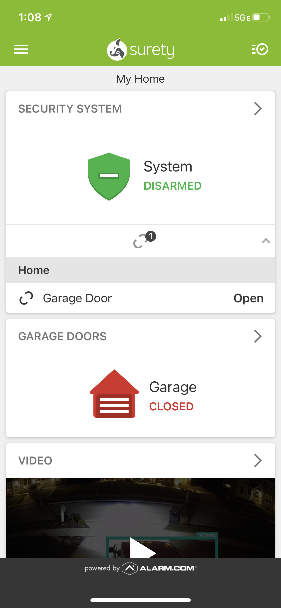

I just checked the app and NOW the garage door is showing open. Weird
I had sent a status check command and the system immediately updated with the open status.

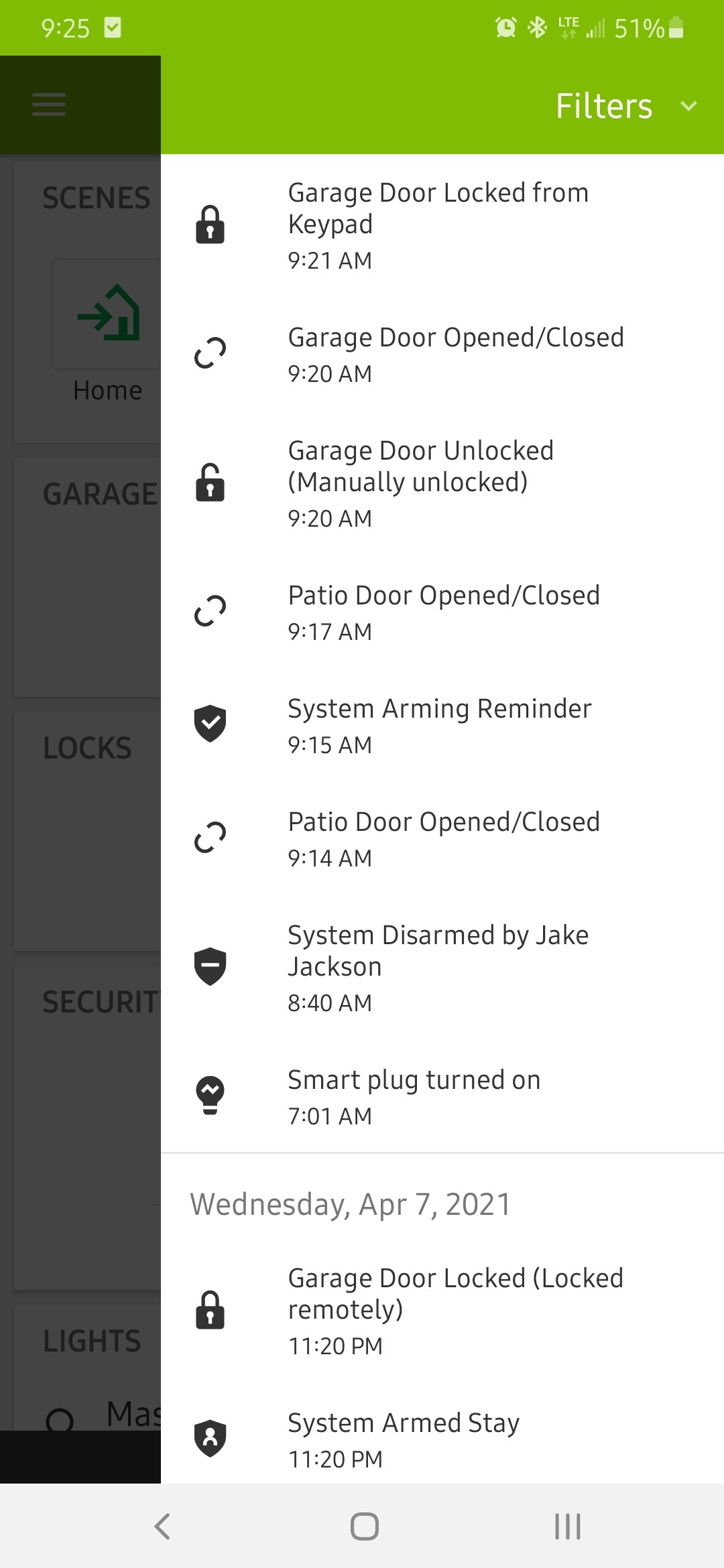

Hey Jason, its happening again. History doesnt even show the door opened when I left. Alarm.com shows open right now but it didnt get the close.
