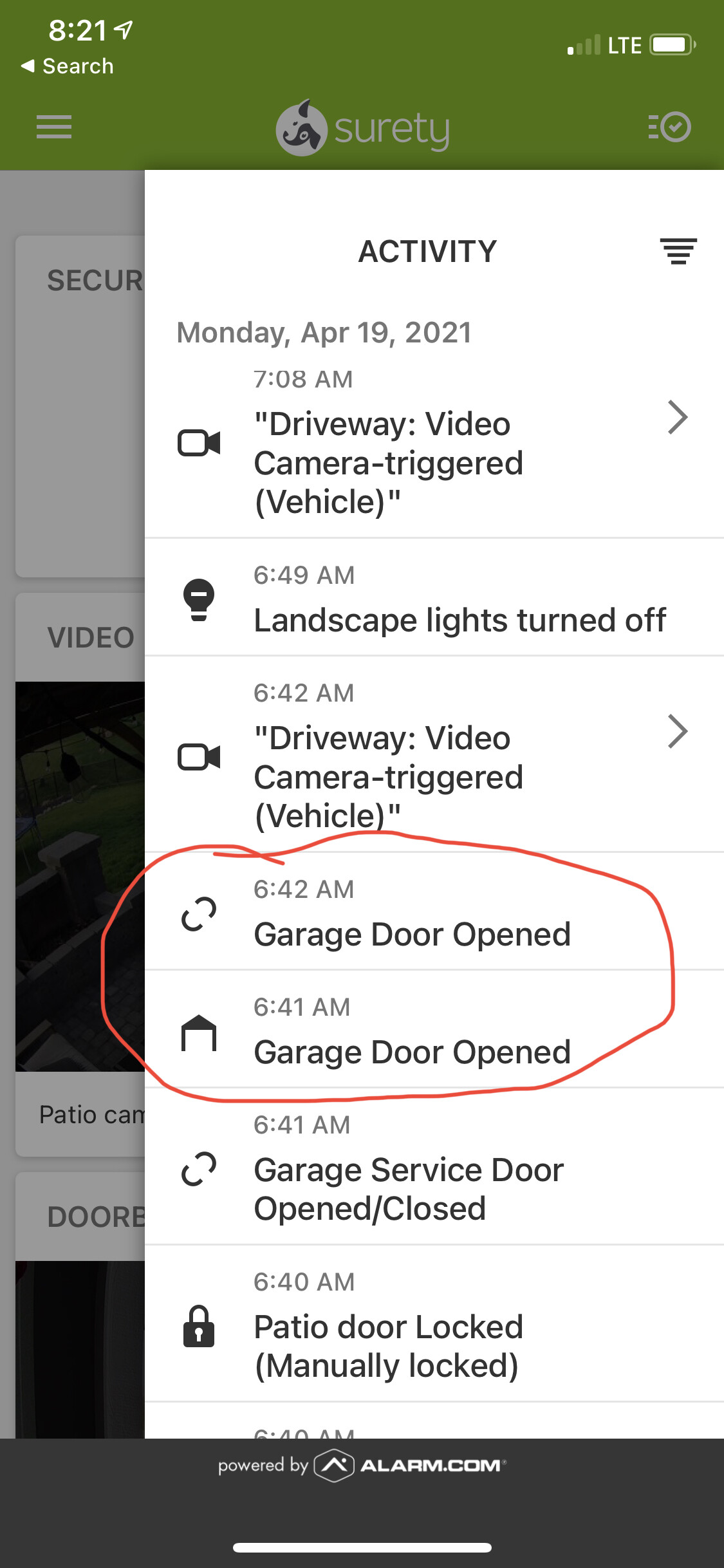

If I were to draw a straight line from the opener to the gateway it would be maybe 12 feet. Theres something going on with alarm.com and liftmaster. It cant be the gateway. The app showed opened the first time today, but it did not show in the activity log. I just checked again, hours apart I have opens multiple times but no closes. I have left and come back 3 or 4 times and the first close of the day is the last time I came home and did something in the garage before closing the door.

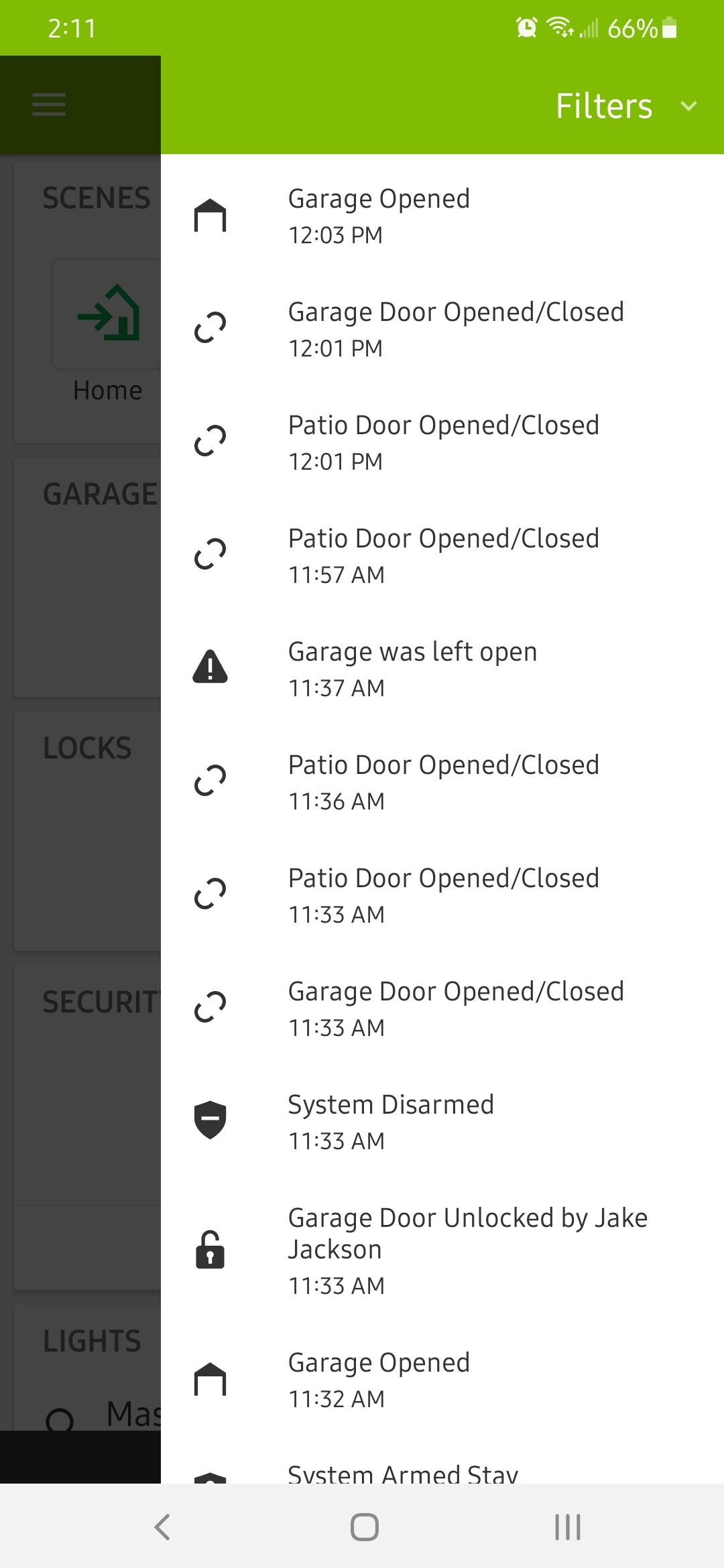

@jwcsurety So things seem to function correctly over weekend. This morning I opened the garage door and it functioned correctly but when I closed the door, the liftmaster still shows the door is open. The tilt sensor on the door itself is reporting it closed. I have attached pics for reference. I will continue to monitor and update. I have not been able to determine why there is sporadic errors in the liftmaster status of the door.
Thanks. Iāve gotten another report of this too and am forwarding all the info to Alarm.com. It does look like there is a potential status issue with Liftmaster or their integration with ADC. It appears to be intermittent.
