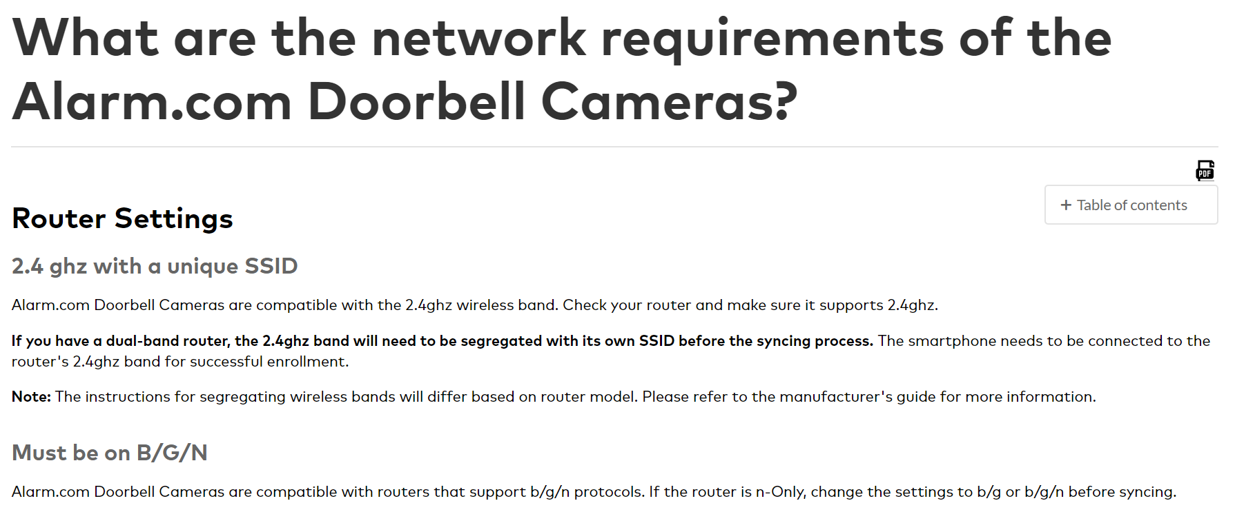

Why is this an issue?
See attachment from Alarm.com.
The Skybell is a 2.4 only device. If the 5ghz SSID broadcasts the same as 2.4 there can be issues as the Smartphone needs to be connected only to 2.4 during setup and the Skybell can only communicate on 2.4.
Likewise it looks like the EX2700 is a 2.4 only device. I am always wary of unexplained “optimization features” and it is hard to say what all changed in the firmware update on the router which may be contributing to this issue.
To effectively troubleshoot an issue, the recommended settings will need to be tested, there is no getting around this.
