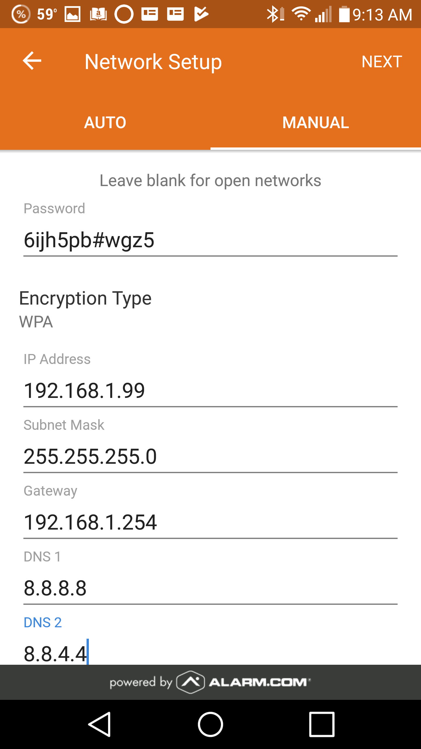

Luckily there should be another work-around. When setting up the Skybell in the ADC App, after selecting the Wifi network you want to connect it to, select Manual at the top (instead of auto). Then you can manually assign a static IP directly to the Skybell.
Select an unused IP address. DHCP usually assigns lowest first, so just use something like 192.168.1.250
If the router is at standard default values the rest can be:
Subnet mask: 255.255.255.0
Gateway: 192.168.1.254
DNS1: 8.8.8.8
DNS2 8.8.4.4
OK. I followed your instructions and entered the appropriate values (see screenshot). The only other item was WPA. According to my router, I use Authentication type WPA2-PSK (AES), so I’m not sure it that’s the same.
I verified the gateway & subnet mask with my router info, so those are good. I didn’t see any way to verify the DNS1 & DNS2, so I used what you provided w/o verification.
I still get a briefly displayed error message “Internet unavailable with Skybell_3117957119” when I select the AT&T extended wi-fi address, but then it allows me to manually set the information you have suggested. I used 192.168.1.99 as a valid unused internet address.

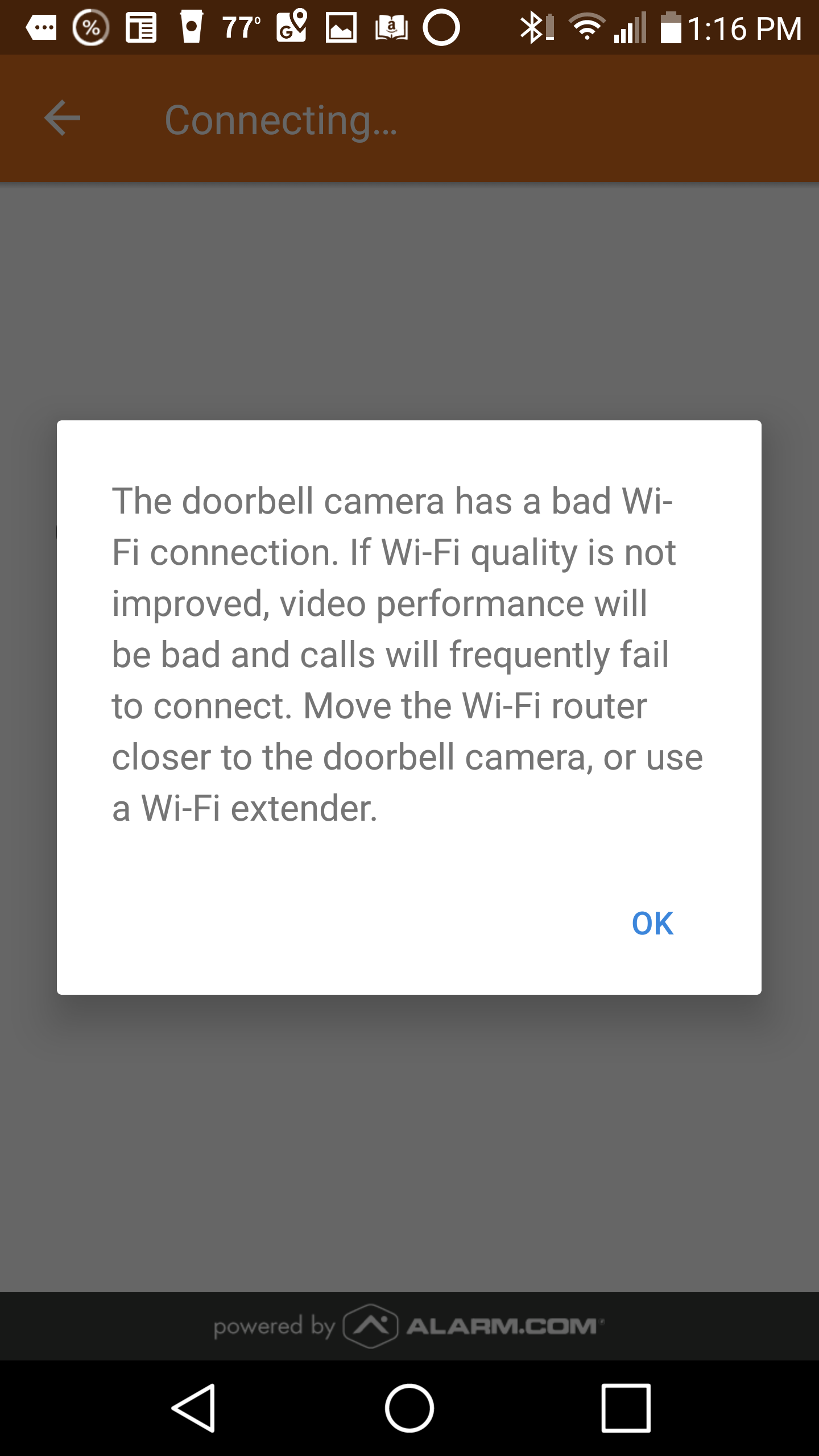

Successful, but with “bad Wi-Fi Connection” (see screenshot).
OK, this is the farthest I’ve gotten in over a week!!!
