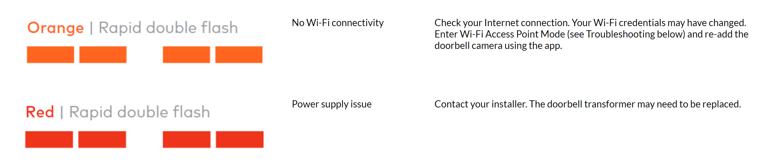

Is it red or orange? is it a double flash? See the attached image for more details. Both of these issues are local issues, however we can assist with trouble shooting. If there are other colors flashing, please let us know which colors and what order they are flashing.

Flashing red is an electrical/ power supply issue.
The Skybell is usually powered off the transformer on your 110v/120v. Go check this.
It looks more like an orange double-flash.
