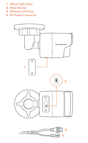

Pre-setup checklist:
- ADC-VC726 camera (included)
- AC power adapter (required for non-PoE connections)

Connect the camera to the router via an Ethernet cable. For more information about connecting video devices using ethernet, see here.
If the Ethernet connection does not provide power, connect the camera to the optional AC power adapter (sold separately) and plug the adapter into a non-switched outlet.
