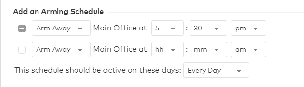

  1. In Add an Arming Schedule, select the automated system action from the dropdown menu.
  • To create a schedule that only performs one arming action (i.e., Arm Stay or Arm Away), use the dropdown menus to configure the first arming action and click to deselect the second arming action option. This sets the schedule to only perform one arming action.

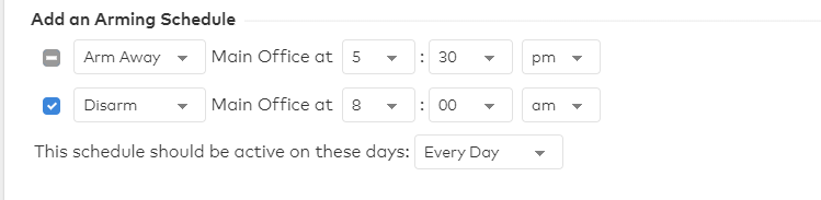

  • If a second automated system action is desired, click to enable the second arming action settings and use the dropdown menus to configure the second arming action.
    Important If an Arming Schedule crosses midnight (e.g., Arm Away system at 10pm, and Disarm it at 7am), the second arming command takes place on the following day. For example, if you set the schedule to Arm Away at 10pm and Disarm at 7am, Mon-Fri, this means that the schedule will conclude with a Disarm at 7am on Saturday .
