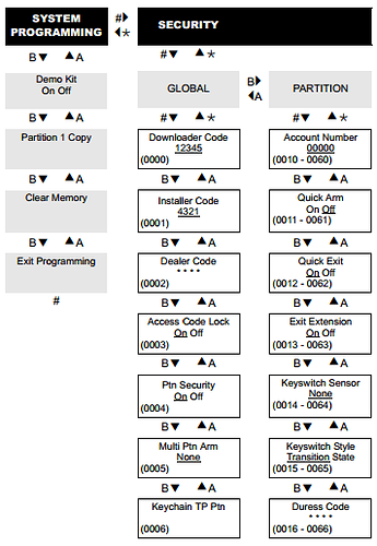

To disable ACL using the Concord 4 keypad:
  1. Press [8] . The screen displays Enter Code .
  2. Enter the installer code (default is 4321). The screen displays Enter Command .
  3. press [00] to go to System Programming.
  4. Press [#] to enter programming.
  5. Press [0003] for the shortcut to go to Access Code Lock On/Off.
  • Alternatively, to manually navigate to Access Code Lock:
    1. Scroll to Security, then press [#] to select.
    2. Scroll to Global, then press [#] to select.
    3. Scroll to Access Code Lock .
  1. For Access Code Lock , press [1] to turn ACL off. The display flashes the entered setting.
  • If [2] is pressed, then ACL is turned on.
  1. Press [ #] to confirm the setting.
  2. Power cycle the panel after turning ACL off.
