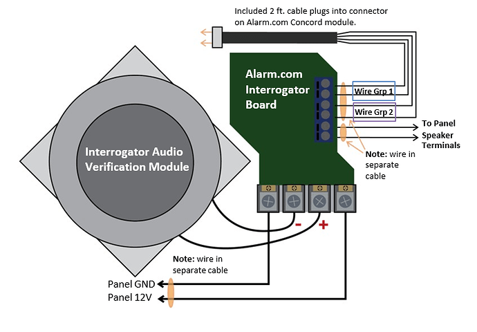

  1. Connect the Alarm.com Interrogator Board to the Concord panel and to the Voice module as shown in the following wiring diagrams. The Alarm.com-compatible interrogator board replaces the native GE interrogator board, which is typically tan in color.
Important : When wiring the interrogator board, use 18 or 22 gauge wire.

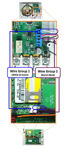

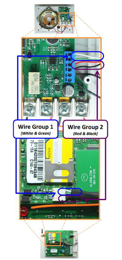

  1. Connect the interrogator board to the Alarm.com cellular module, using the included connector. This connector plugs into the Alarm.com module on one end and has four wires on the other end that are wired into the Interrogator Speaker/MIC terminals as shown in the following image. If using an LTE module, connect the wires into the Audio terminal on the module.
  • Longer wires can be spliced onto these four connector wires to customize the distance between the Alarm.com module and the interrogator board. The total distance between the Alarm.com module and the interrogator board should be no longer than 150 feet.
Note : It does not matter which of the two wires in Group 1 and Group 2 run to each terminal within the terminal groupings, so long as Group 1 wires run only to Group 1 terminals and the same is true for Group 2.
