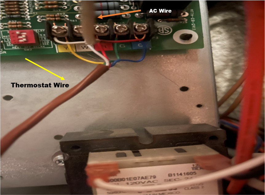

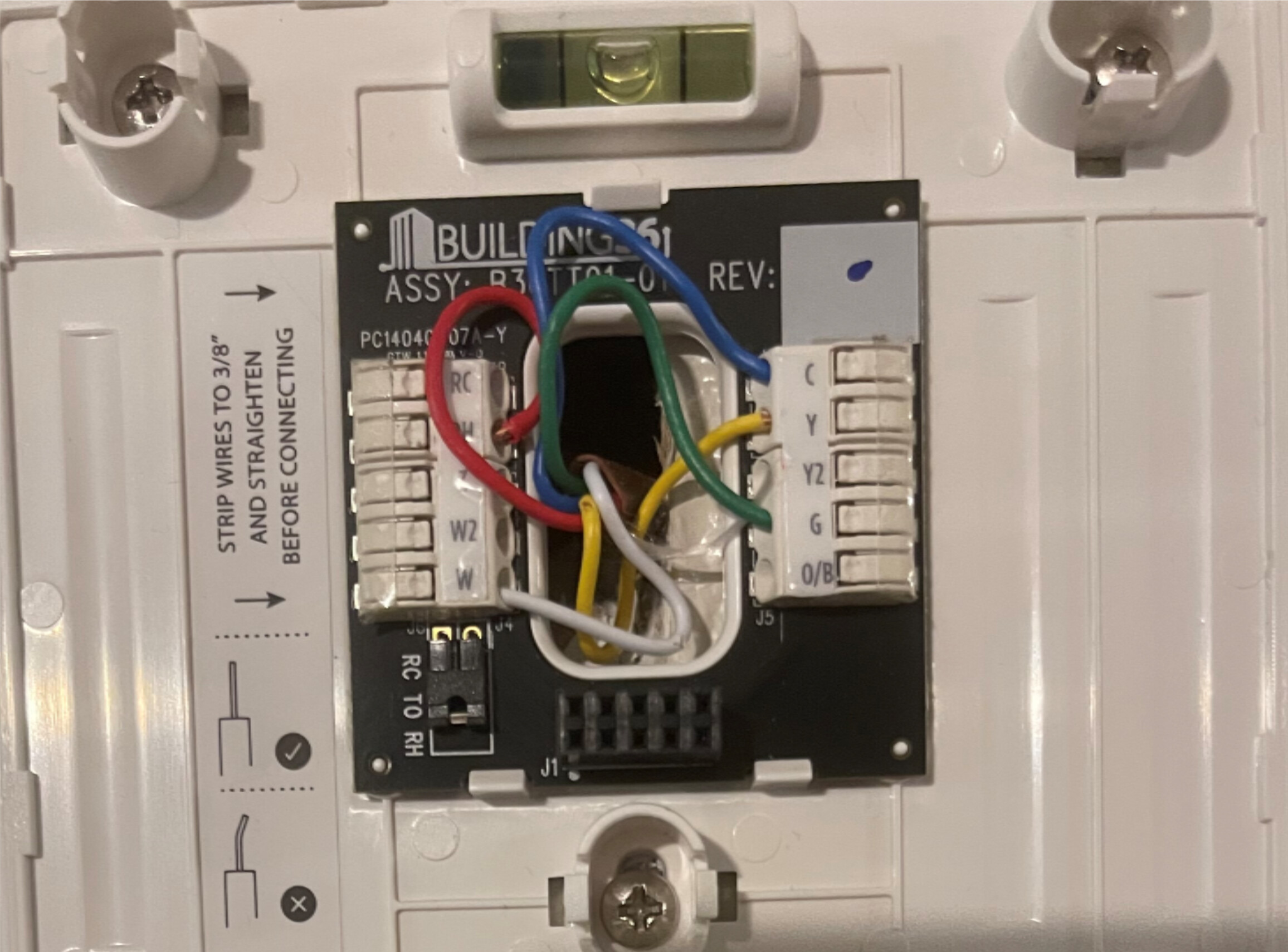

New to posting on Reddit. I have the Qolsys 4 panel under Suretyhome Complete. I need help with wiring of t2000 thermostat for my Goodman furnace and Goodman AC. It did not kick on when wiring was complete. Older programmable Honeywell thermostat wiring was very fragile from the wall and kept snapping so I ran new wiring. It is showing up on panel but says it is off. Could someone post a link or provide suggestions on wiring correctly?

Also, was the AC wiring like that previously? I believe the red wire typically connects to the Y terminal, while the white wire connects to the C terminal. However, I recommend double-checking with an HVAC technician before making any changes to these connections.
I have removed and reinstalled the thermostat. HVAC tech confirmed wiring is correct; however, system keeps saying a new thermostat is detected. I have gone through wire identification several times and received the “finished” notification. What do you suggest?
