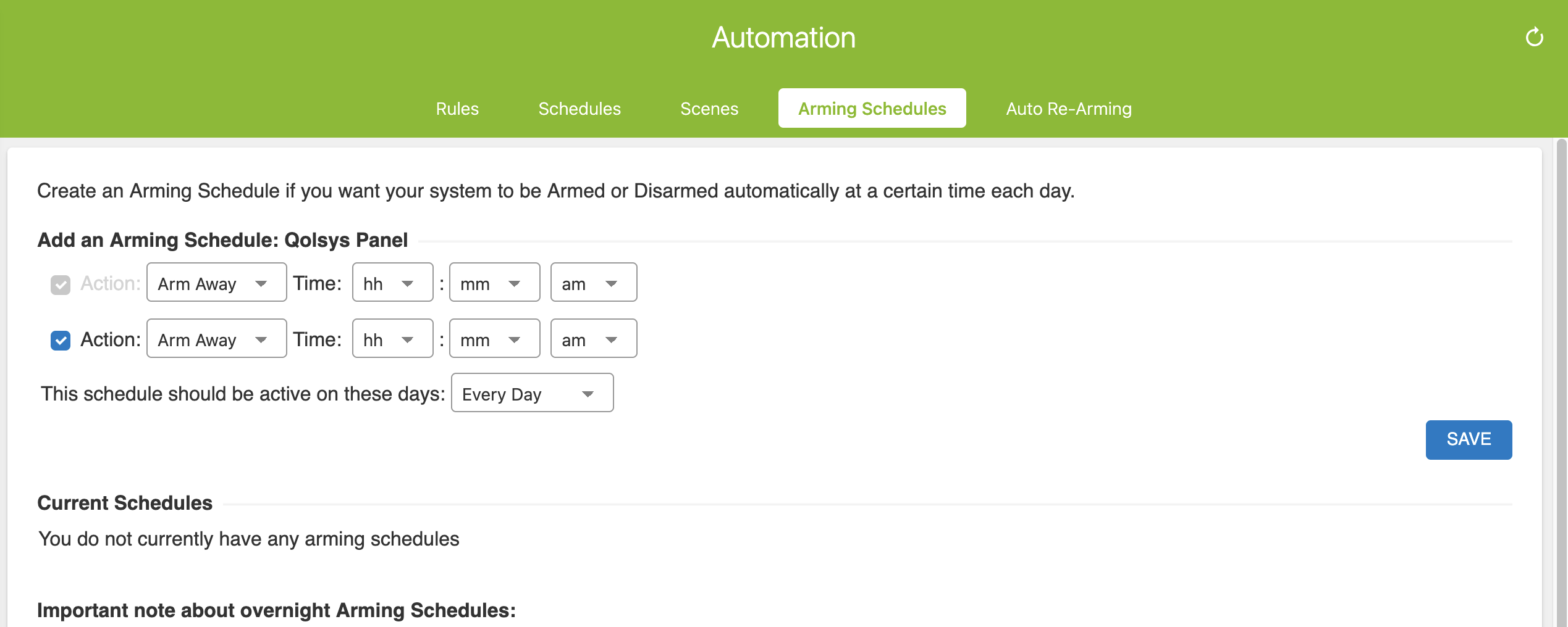

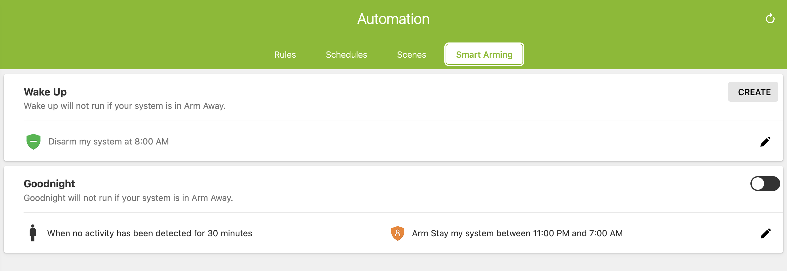

Arming Schedules and Smart Arming are distinct different features and do not use the standard Rules or Schedules tabs in Alarm.com. They have their own sections. See the images below.
By default Smart Arming is enabled on plans.
If you add the Arming Schedules feature to your subscription in the system manager, Arming Schedules replaces Smart Arming.
If you need Arming Schedules, see the guide here for how to add that feature on your subscription.
