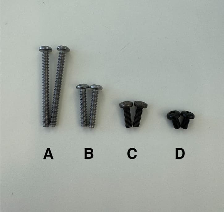

Screw usage guide included in the ADC-VDBA-755P-MNT kit:
The ADC-VDBA-755P-MNT includes a flat adapter that can be used for installations where the single-gang box is installed in a way that requires the adapter for the ADC-VDB755P to be installed flush with the wall plate.
Note: Only one screw set, A or B, needs to be used; two different lengths are provided for the installer’s preference. Screw sets C and D are optional only if the installer wants to install the wedge or flat adapter on top of the wall plate.
Screw set A:
- Screw size: 6-32 x 1.5"
- Standard Installation: Use to screw the VDB755P and wall plate to the junction box.
- Wedge or Flat Adapter Installation: Use to screw the wall plate to the junction box.
Screw set B:
- Screw size: 6-32 x .75"
Screw set C (optional):
- Screw size: 3.5mm x 10mm
- Wedge or Flat Adapter Installation: Use to screw the wedge or flat adapter to the wall plate using the diagonally oriented threaded inserts.
Screw set D (optional):
- Screw size: 3.5mm x 6mm
- Wedge or Flat Adapter Installation: Use to screw the VDB755P to the wedge or flat adapter.
